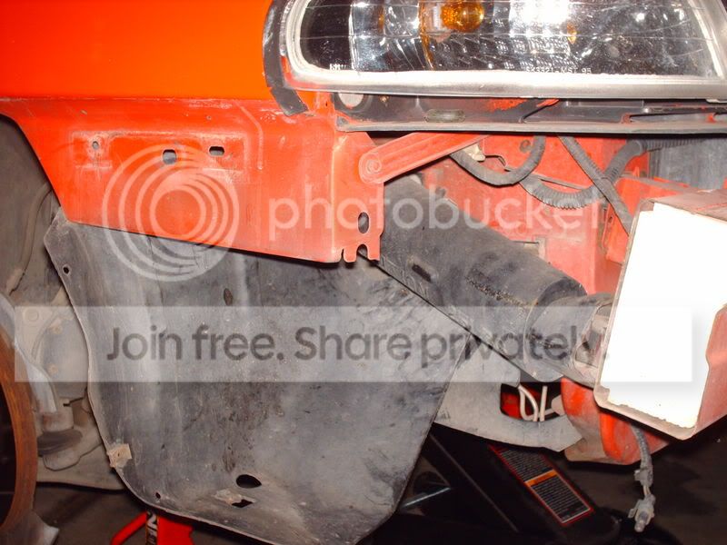

yup the weight even says 25lbs. Ill tell ya what it takes when i get there. mines not a dd though. i also took out my bumper in the front.
