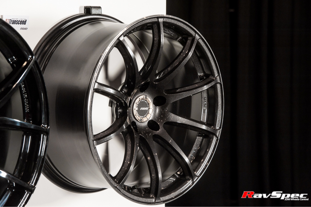

As for the wheels I think I'm going to swap the 40/18 tires onto the FR500's to fill the wheel well a little better. Also considering some extended ARP wheel studs so I can run MM hub centric spacers. These wheels are just to hold me over until I can make a decision on the right wheel/size/offset combo. Right now I'm looking at these in 18x10 +20 all around. They are roughly the same price as the 18x10.5 +15 RPF1's but won't require me to come up with some kind of flare in the front.
L
LongLostLatz
Oct 14, 2016
51
Yeah they are really nice and they are pretty light at roughly 22-25 lbs. Do you guys think that sizing will work on the front with a roll/pull? I know I will probably have to run a small spacer on the rear to push the wheels out a bit.

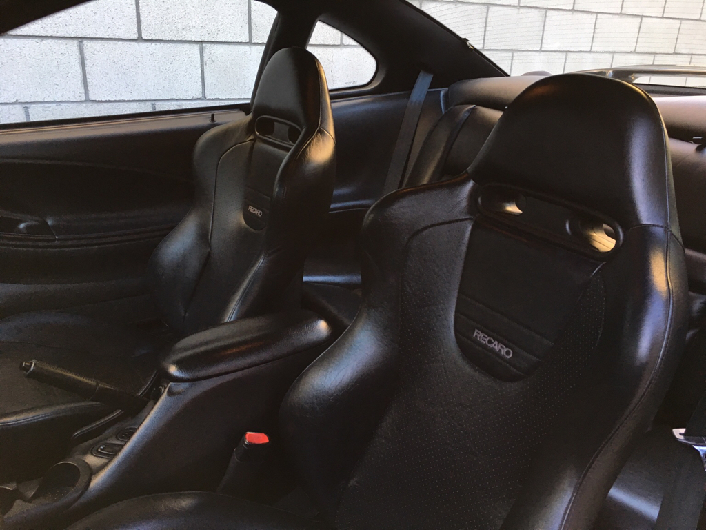

Ok quick update Sal over at Gear Driven got the shifter issues all worked out. It appears that the rattling was due to the use of the gasket rather than the RTV. I guess I didn't tighten the bolts enough because I was worried about how much of the gasket was squeezing out. He installed the MM adjustable clutch cable and quadrant which put the clutch in a much better position and the actuation is so much smoother and more direct. He was also able to correct the thread pitch on the Hurst knob so I wouldn't have the deal with the LMR runaround. I finally located a matching passenger seat and got it installed which I think turned out pretty nice. Now I just need to ditch the rear seat and possibly replace the stock steering wheel with an FR500 wheel or maybe a Redline kit and the interior will be set until I reupholster the seats. I just ordered a modified road and track box and some stainless brake lines so that will be next on the list. Anyway let me know what you guys think.
sleepn_sn95
Sep 6, 2008
2,420
59
Indy
Love the seats. Were they OEM in something or only aftermarket?
They look very similar to OEM Evo 8 seats.
