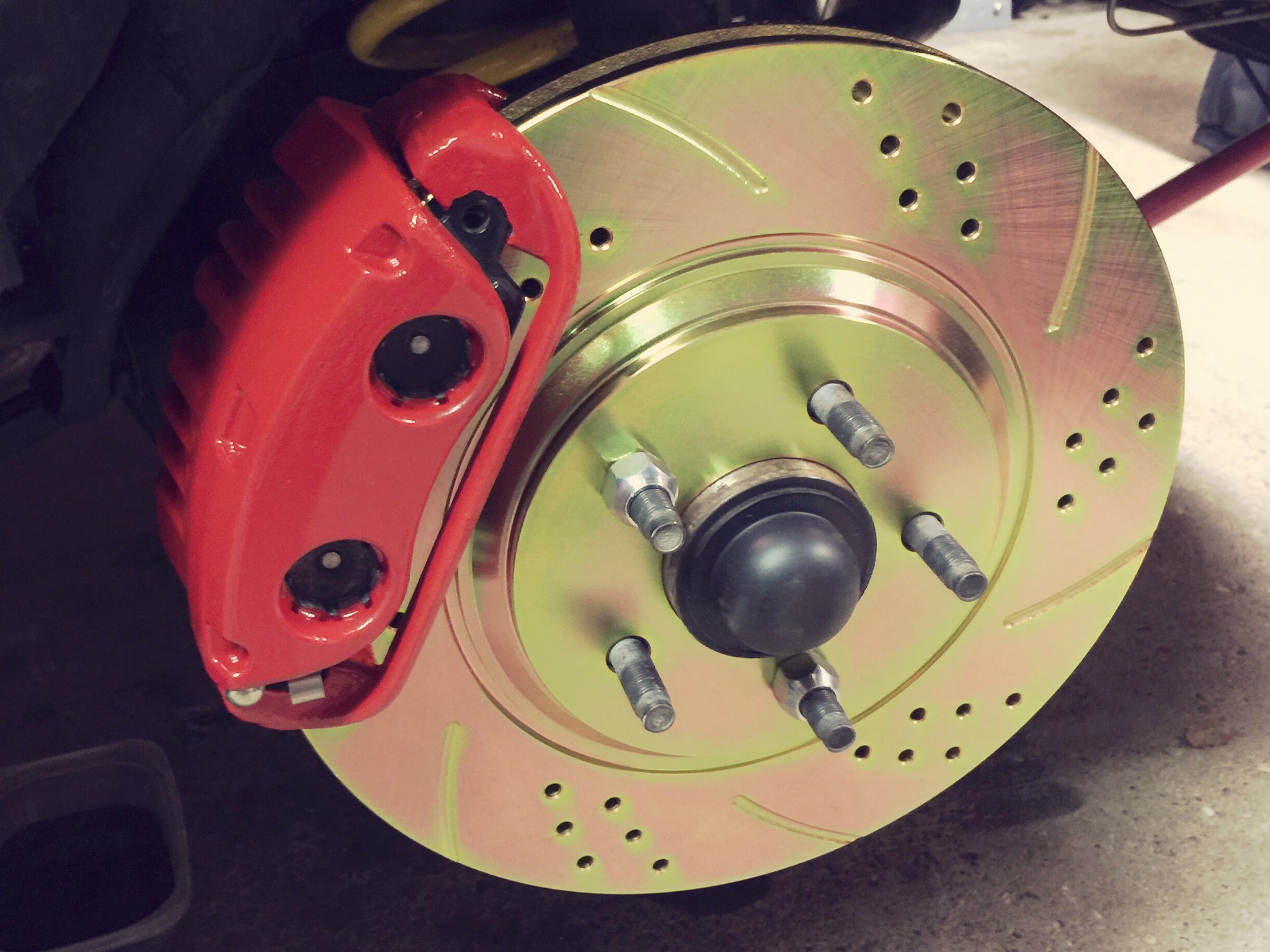

Allen gotta admit the "COBRA" lettering would have been nice however I'm pretty happy with the end product. Got em bolted on this morning before some OT at work.
I'm happy with the look. Now I have to do the backs at some time this summer so they match!
get a decal for a few bucks and no one will notice
