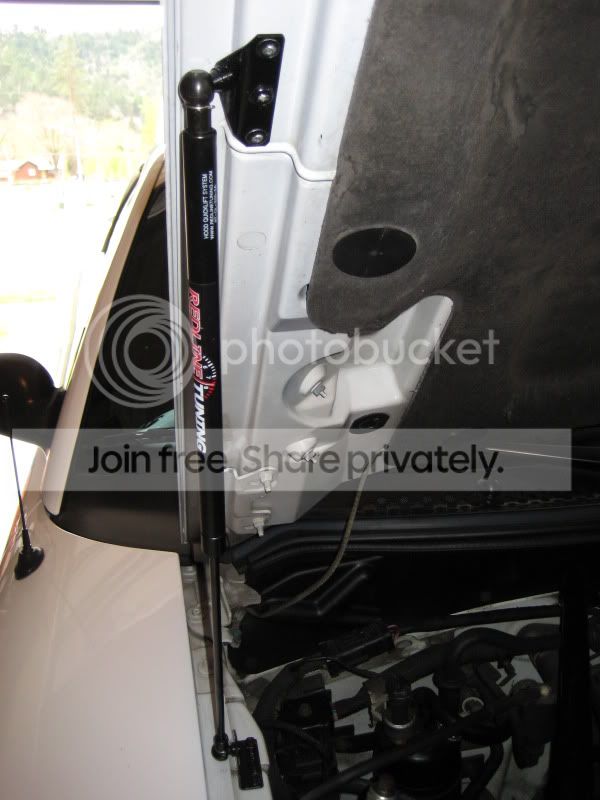

Not as many hood strut options for our SN95's & I was reluctant to do all the drilling & riveting these required...but it wasn't so bad. I really like them now that I got 'er done. I did have to have my wife's help on one part. I have pretty bad arthritis in my thumbs & as a result have almost no grip, I could NOT squeeze the pop rivet gun hard enough to finish the steel rivets! LOL, but with her added hands over mine we did it.
It was so bad I had to ice my left hand down last night for hours before I could sleep...but all worth it now...the prop rod is gone! Funny how simple lil mods make one feel so good.

Always a nice addition when you loose the prop rod. Cleans up the whole setup.

I had this done to my car within the first week of owning it, worth every penny

Matt94GT said:
those are on my to-do list, was it hard to get your hood to line up perfect or does it not effect that?
No effect, the hood mounting isnt even touched. All you do is place the brackets where they tell you to, mark, drill, pop rivet, done.

OnyxCobra said:
Matt all you have to do to fix the lettering is just swap the struts to the other side.
LOL...or stand by the door & read them from the other direction! I'm not sure where I got the oil fill cap...I think it was Calif Mustangs.com I'll check my records. It is a very nice Billet piece feels like very good quality.
Thanks everybody it was fun to do...not bad at all really.

Quick question about those struts. Do they fit aftermarket hoods?
I know for my hood it took some customizing of the bracket to make them fit since the underside of the hood is different from the stock one.
