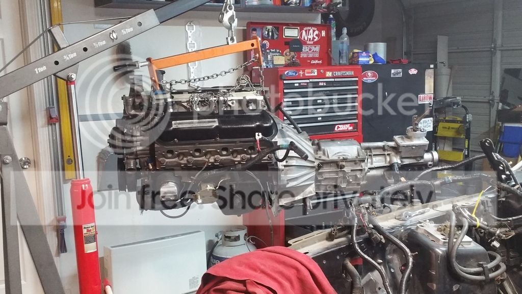

Tense Moment, but I stabbed the motor and trans together with my son's help. You can see the new poly motor mounts in this picture, but I did away with the filter relocation kit. I think a stubby filter is fine.
32,657
5,665
looks like its getting ready to be really tight on space in that bay! Got your shoe horn ready?

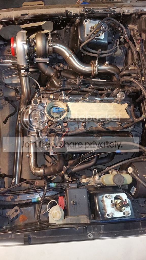

I went through the whole top end again over the weekend and I found some obvious rookie mistakes.
1. I did not have the manifold tightened to torque specs, and I had a nasty vacuum leak
2. I had a coolant leak at the temp sensor

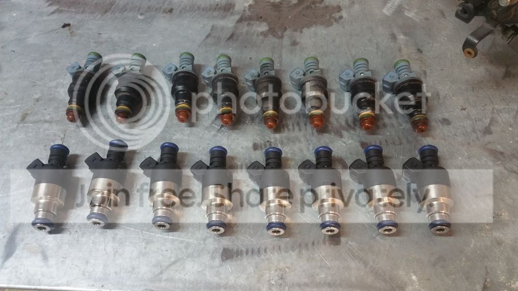

After fixing these things, I went ahead and put the 42 pound injectors in, and installed the new Pro-Tube maf into the charge pipe. I also drilled and welded a bung into the valve cover so I can install a catch can soon. I will post some pictures as soon as photobucket stops being retarded.

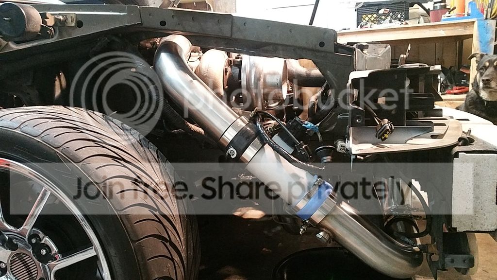

So I installed new 42lb injectors and the Pro-Tube last weekend, trying to fix my issues.
But the same thing happens. LOADING UP. running super lean, no matter what I do I cannot make it idle.
T
Turbulence
Dec 9, 2016
77
Sparks, NV
Also installed the new pro-tube with calibrated MAF, installed into the charge pipe.....done away with my attempt to use the Draw Through.

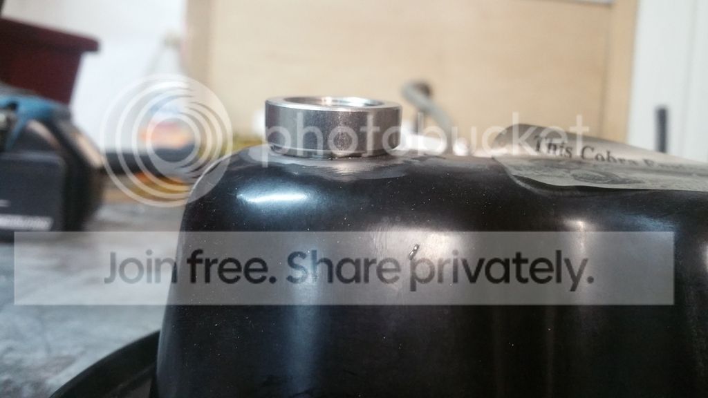

I also have been told that I need to change my valve covers from the factory black cobra covers to allow for some catch can tubes....but I like the factory look, and I can weld...so I decided to use an extra O2 bung, and drill and weld it myself for use with 6 AN fittings.

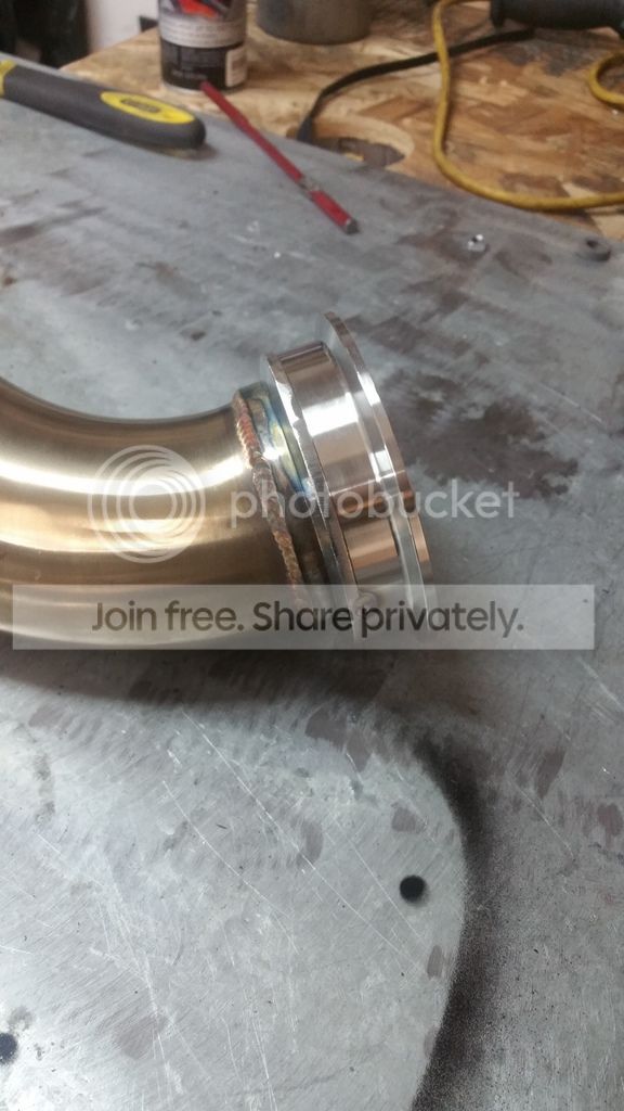

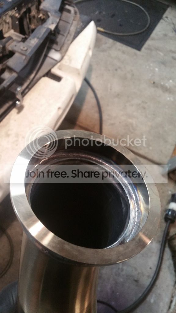

I also decided to go back to my original plan, of using a Garrett/Holset Hybrid 70mm turbo before I bought the On3 Kit. I had to make an exhaust adapter, since the Vband on the Garrett was 3 1/2" and the On3 was only 3".
