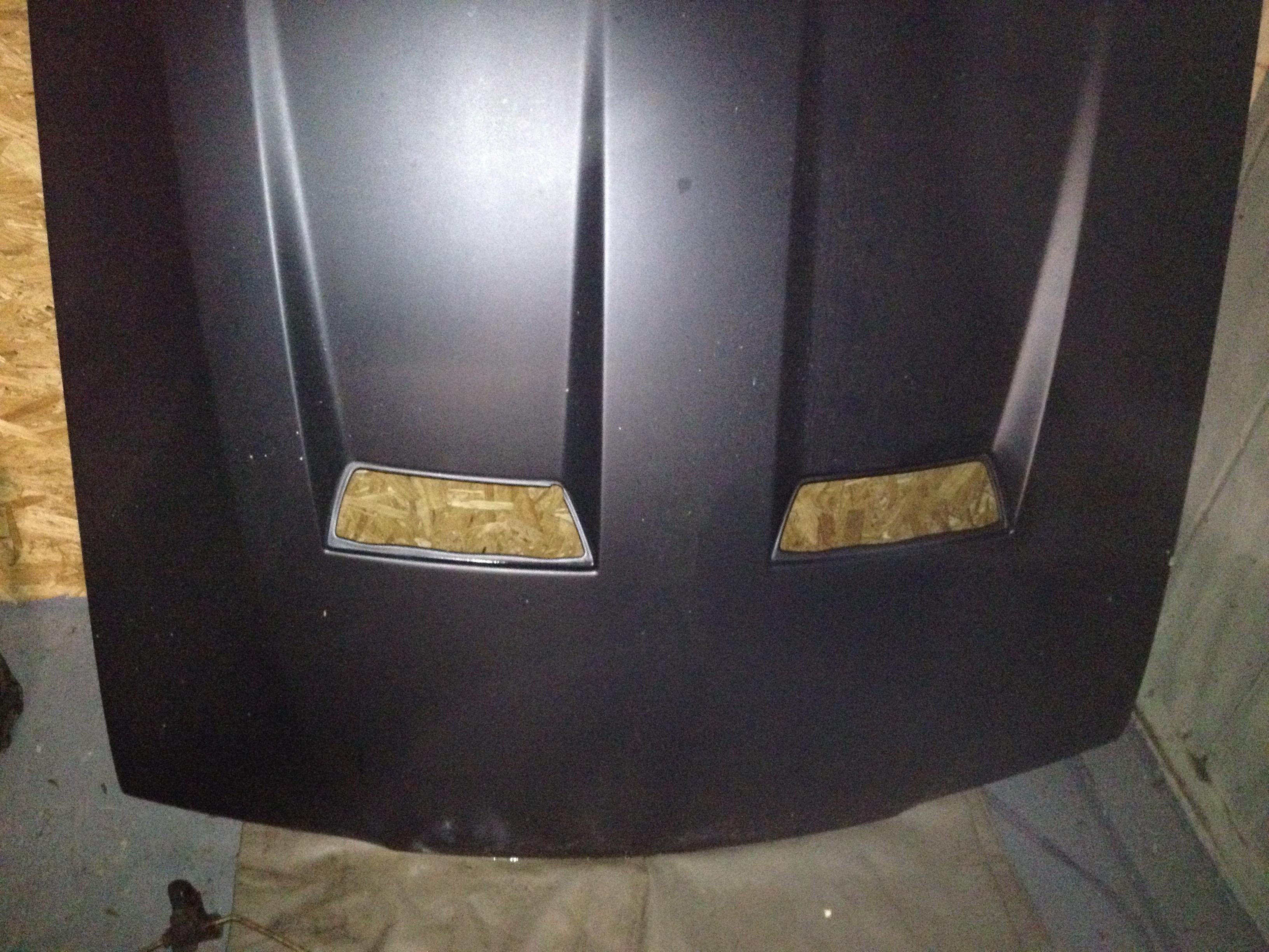

If ya wanna cool you need something like this...................
That’s with the vents taken out. I’ve got pics somewhere that I can possibly find with them in. I noticed a lot better temps once I got my hood.
