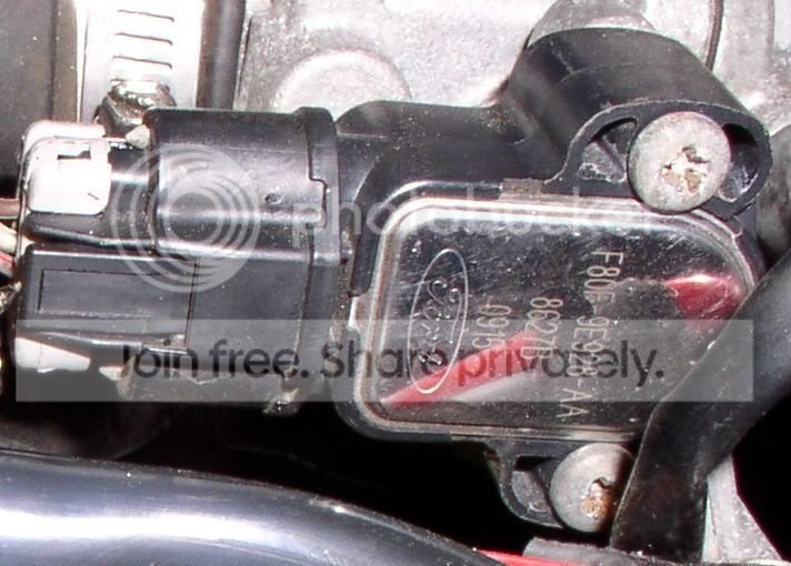

2. Find the TPS located on the front of the throttle body (see pic below)
3. Find the center beige wire and pin the center of the wire with the safety pin (I like the safety pin because I could rest my +POS probe lead in the center coil of the pin) or use your paperclip and slide it under the connector boot above the center beige wire:

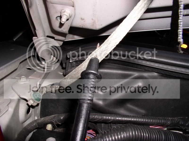

4. Find a good ground to attach the -NEG probe of your Multimeter. I used the ground strap coming off the hood body,as you can see It was great to hold my probe. Or you can use the battery -NEG or any GOOD ground source.
5. I then turned the key to the "On" Position, but don't start the engine and read your volt meter, If it is between .96-.99 your in good shape (So I have been told, and you don't need to touch anything) Mine was not! If yours is not reading between those parameters loosen the 2 Phillips head screws hold the TPS just enough to free it up to move. Then with the throttle closed you want to move the TPS slowly until it reads within the range. I set mine at .98.
6. Once you have the setting within range, tighten down the screws and take a peak @ your voltmeter again to see if it has moved, if so, loosen the screws and try again. Once you have the reading set to the correct voltage, open the the throttle wide open (my reading @ wide open throttle(WOT) was 4.73 Volts) and close it a few times and check the closed reading again to make sure it is in the range. When I was finished I pinched the wires I had probed with my fingers and a slight rolling action to close up the pin holes.
