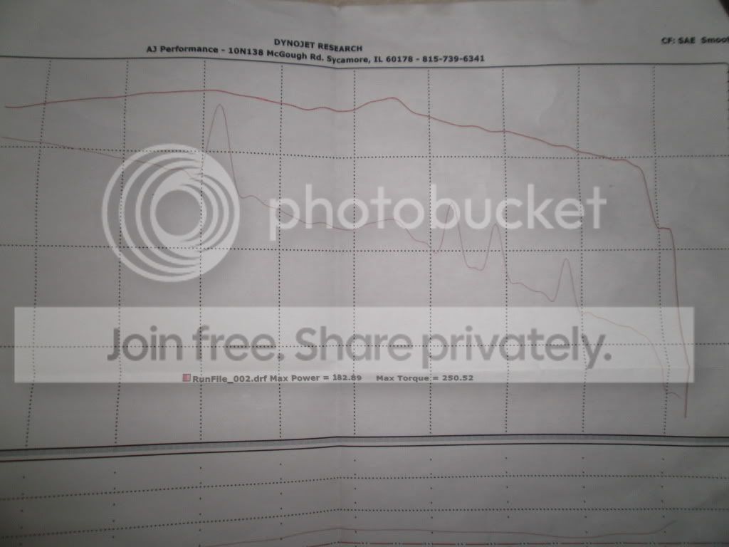

Here yeah go the dyno guy says that looks like an ignition problem what do you guys think?
Top is horsepower bottom is torque

I'm not a 2v genius like duffy, but wouldn't improperly installed cams/timing components cause a roller coaster like that? My HP/TQ numbers on my HCI 302 where VERY smooth thankfully. Definatly something wrong here...

Id idnt see the dyno sheet till now but yea there is an issue. Wheather its incorrect cam installation I dont think so but there is something else going on. I honestly dont know.

Air to fuel is pretty good. Im gonna run a compression test sometime soon to see if i can find a problem.

well there's your problem sir your A/F is wack! It's supposed to be a virtual flat line sir and it has spikes. And from the looks of it when it does spike, it spikes rich. That leads me to believe your ignition is toast and/or your tune is junk.
For reference I had a similar issue when I got dyno'd, the COP's were beginning to fail and between 5000-6000 it started spiking and you could see the A/F dip into rich territory.
