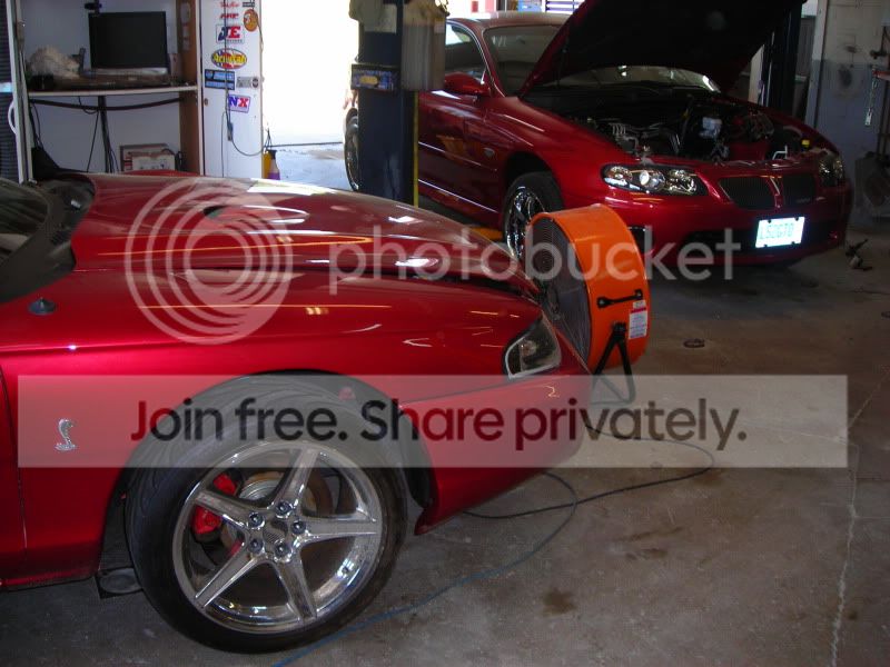

Friday when i got out of work, I had the car towed over to the shop.
So I got a text from the shop owner last Friday afternoon:
It was kinda like fate. Apparently, the car arrived just seconds before the short block. it's like they can't wait to be joined together!
Then Monday, I got this:

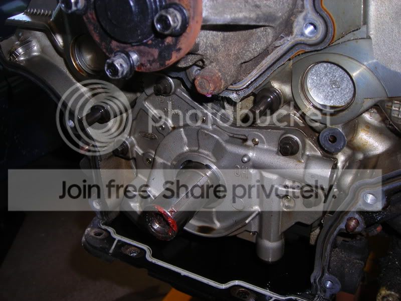

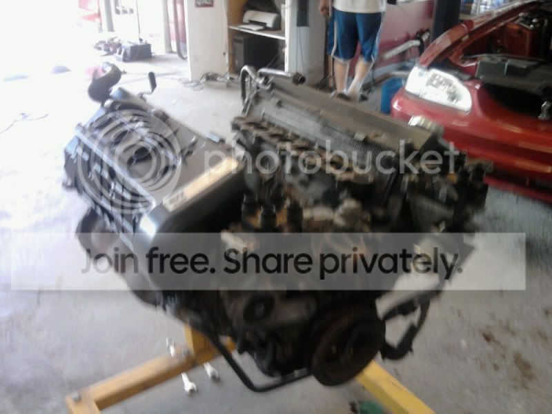

Well, today I had the day off, so i took a ride up to the shop. As always, it was very clean. I just wanted to check out the work in progress. :rockon:
The heads will be getting sent over to Modularheadshop - MHS They are highly recommended from damn near everyone I've spoke with. I'm getting them completely rebuilt and having them open up the exhaust ports to Termi head specs, as well as bowl port the short side radius of the intake port. I also have a Helicoil in my #7 plug hole. They will be installing a Timesert in there for me.
The heads will be shipped out either tomorrow or Friday.

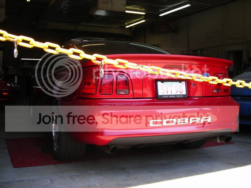

NOICE. Yeah I'm copying the ass end of your car as soon as I get it repainted. Black lower valance and chrome letters.
37,641
7,760
KWClutch said:
NOICE. Yeah I'm copying the a*s end of your car as soon as I get it repainted. Black lower valance and chrome letters.
So, ah technically, you like his ass?! With that motor you can like who evers ass you want.........
