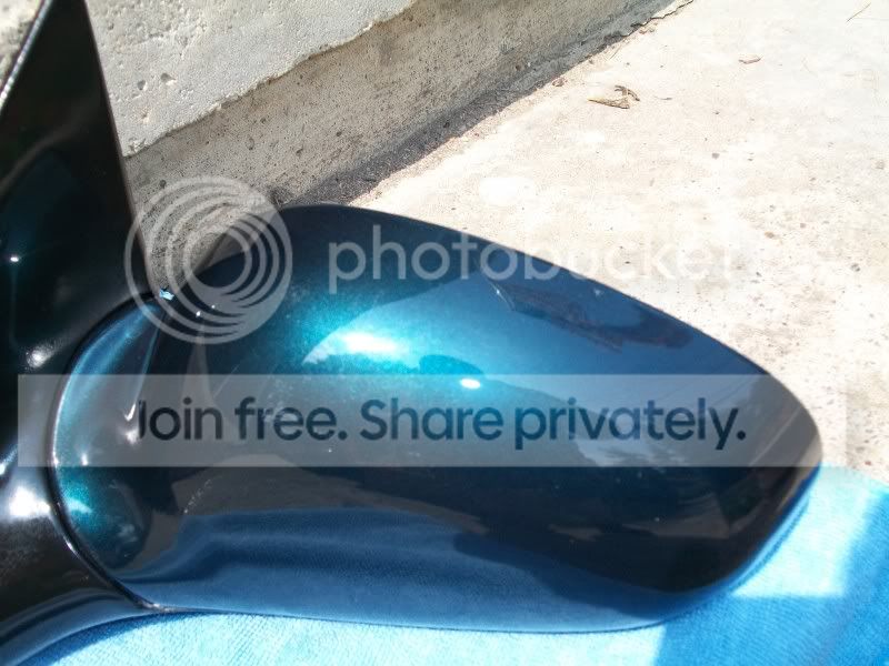

Here are my mirrors that I rattle canned. The paint came out good but the imperfections were in the clear. I sprayed 3 light coats and still had some clouding and bubbling. The mirrors were prepped well and the paint laid nicely.

Nice. That looks way better then the flat paint on my hood lol. One guy i know suggested for larger panels taking two cans and syncing the spray line up of the two cans in each hand while you crossover. He claims it gives much more efficient flow and a better final product. Not sure how i feel about 2 cans but in theory it seems smart.
