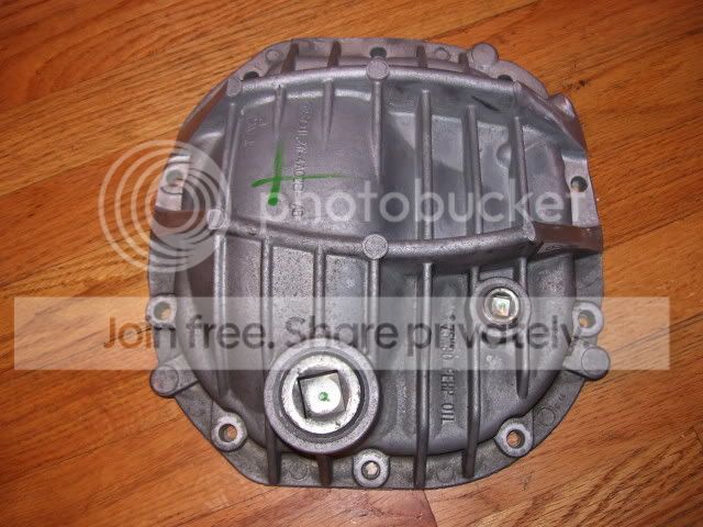

Here is the stock Explorer cover:

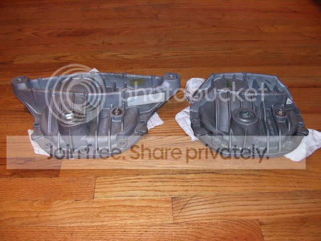

Side by side stock explorer and modified cover:

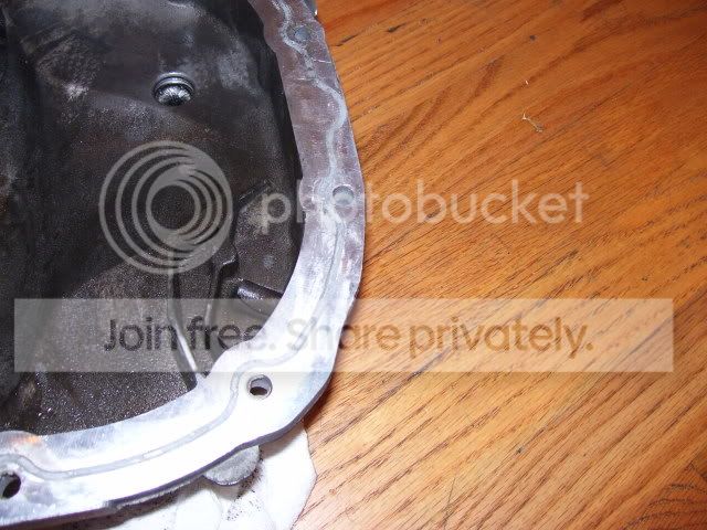

Check out the laser cut valley around the inside of the cover to ensure a positive RTV seal!
A zizwheel was used to cut the ears off of the stock cover then I ground out the rough edges of the cut to make it smooth. With a little more time and effort, you can really make the cover look great! This is a nice option for those who don't want to spend an arm and a leg for an aftermarket cover! If these covers are modified, they will fit any Mustang with an 8.8 rear!
