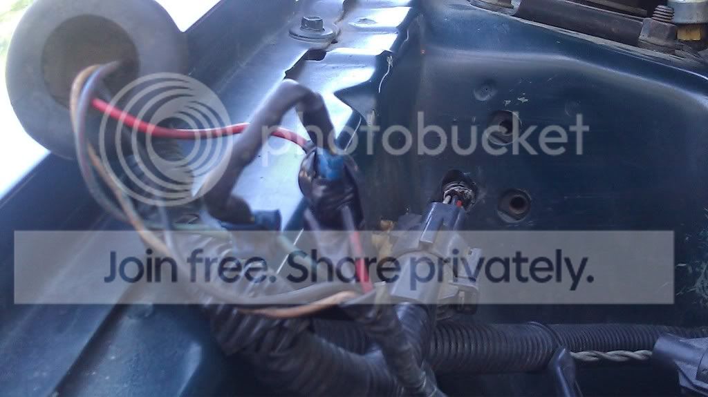

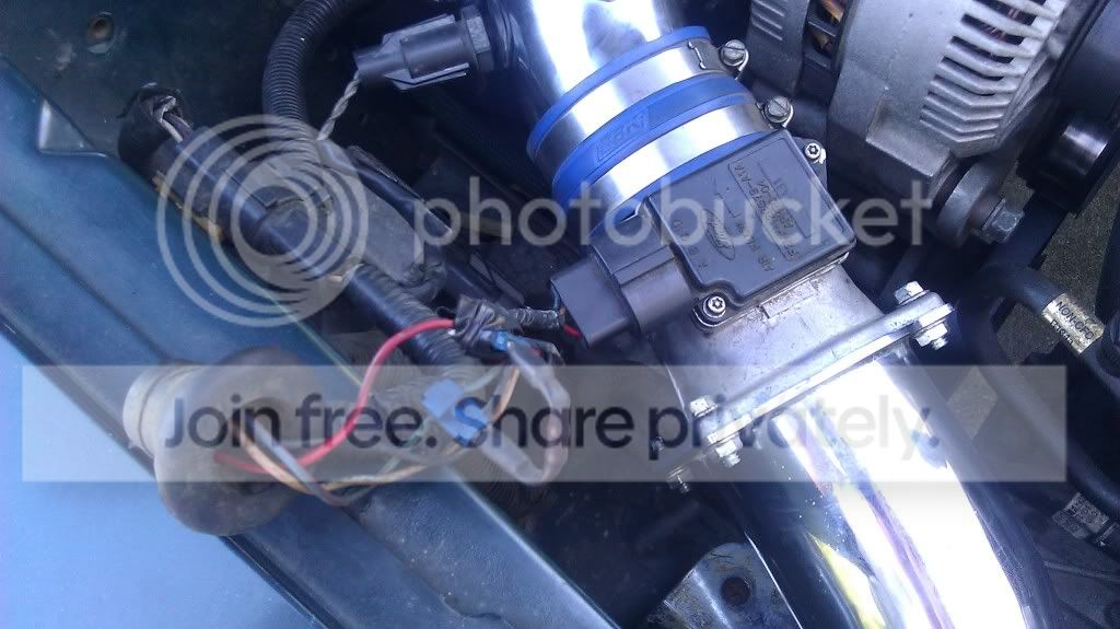

Hi everybody, im new to the site and to late model mustangs. I purchased a 94 GT last week that has a few bolt ons. BBK intake, 65mm throttle body, BBK shorty headers and i'm not sure if its the stock intake upper and lower manifold cause it says (SVO motorsports) on top instead of GT? My question is there is also a BBK FMU on the car, but i want to know if it needs to be on the car with just those mods? Also there is two of the wires connected together w/ a resistor inbetween, at the plug of the MAF, would anyone know why the previous owner would do that?

Post some pics of what you're talking about please. Sounds like some weird stuff, but I'd like to see what you're talking about to be sure. :)

That's a fuel pressure regulator, not an FMU, and it's fine. As for the connection between the two wires with the resistor, remove it and ensure there isn't any exposed wire when you're done. If you pop those blue clamps off, you can wrap a small piece of electrical tape around where the "bit into" the wire and it should do the trick.
Oh, and put a fuel pressure gauge on the car and make sure it's set at 39 psi with the vacuum disconnected. After you're done checking it, reattach the vacuum line.
Paul.
