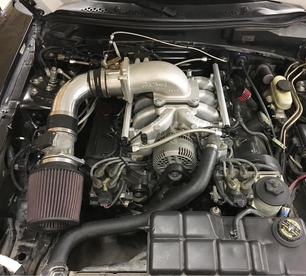

94mm seems like its too much. do you run a carb style manifold? ive got the vic jr manifold too, but use a 72 or 75mm tb. will knows for certain. he and josef also do a lot of tuning stuff on their own cars so theyre probably a good resource
I will agree the throttle body is a touch big but my friend had it and the price was right lol
