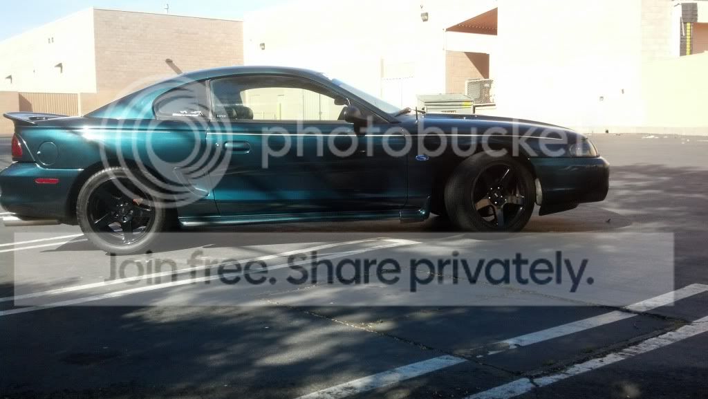

I used the same kit on my chrome GT rims. I only did 3 light coats then 4 coats of clear. They will last as long as you take care of them like any other chrome rim.
