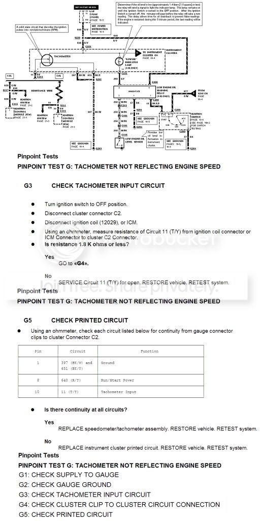

The tachometer started bouncing today...There is NO performance change although the tach is bouncing. Very Strange. The rmp gauge will bounce at idle and while I am driving. But the actual sound of the engine does NOT change at all when it bounces. Car sounds perfectly fine which is leading me to believe this is electrical. Any idea's?
There are NO exhaust leaks on the car just would like to clear that up.
The ignition system....the entire ignition system is about 7months old including the distributor.
The MAF was cleaned about 6 months ago during regular maintenance.
I'd just like to reiterate the car is NOT stumbling when the tach bounces...there is NO sound change what-so-ever so I'm baffled on this one.

Update:
Replaced coil, plugs and wires.....still cranking but not starting.
I checked for spark at the #1 plug....No spark...
I pulled the coil wire off the dizzy and connected a spark plug to it.....no spark....Replaced EEC fuse although it looked fine....no spark
Old plugs were covered in fuel from trying to crank it so it's getting fuel.
I'm baffled...
Wondering if the EEC Relay has failed inside the CCRM...
Why would a brand new coil not produce spark? Maybe a bad fuse link somewhere? CCRM?
I'm stumped and I know if I take it to Ford I'll get raped.
