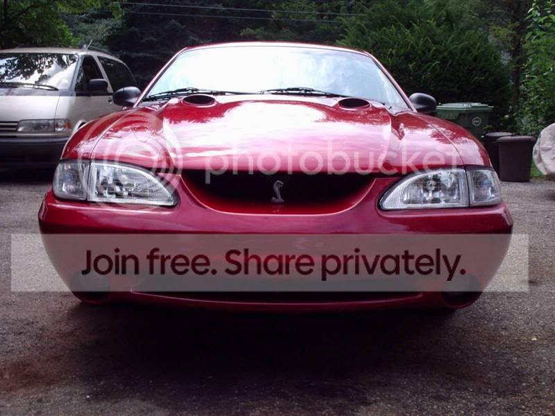

I have brembo drilled front rotors with the hawk ceramic pads, and there is most definetly a noticeable over stock, but then again, the car came with shitty pads and warped rotors sooo advance auto silvers would probably be better than what was on there.
The car also looked like this when I bought it, so as you can tell, it has had some work done to it by me, lol.

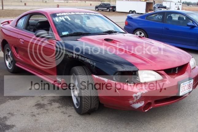

The car currently:
