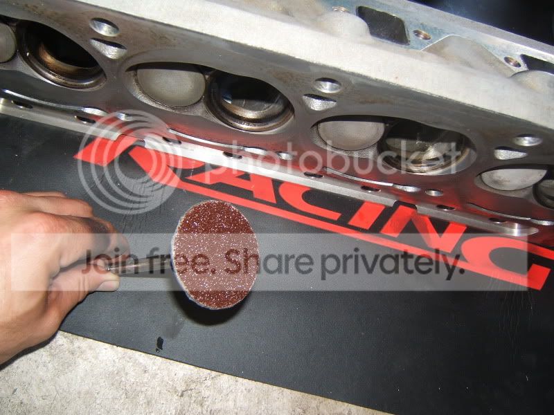

using the old valve is a PITA if you can't get the paper to stick to the valve. I used it for a guide to make an impression of what I needed to cut then I used an air sander to cut out the relief on the piston. Took about 15 mins a cylinder to do including checking and cleaning.
here's pics from when i did it. I came back and hit it w/ the air sander to knock down the sharpness and get it out closer to the cylinder wall and I laid the relief back some for more radial clearance.
of course I did this w/ my performer heads then swapped to the Z304 w/ the same 2.02 valves but the intake valve was moved so I lost a little clearance and couldn't run my cam 242/248 .612 and got pissed and just put the stocker in it.
