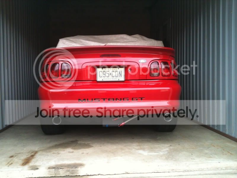

I run Glenns 1000hp system with twin Walbro pump setup. Great quality parts, great customer setup, and looks badass. Highly recommend his products.

Nice, I run his dual walbro system as well but with sumped sleeper tank. Your making me want the rear sump, looks good!

Thanks man! It's not for everyone, i just love the old school sump look. Best thing about Glenn's systems is it is VERY easy to turn your dual walbro pump setup into a triblock and triple pump. Tons of room to grow.

Sump looks pretty sic.... I like the looks of what's in the mmr system. Might have to check out the Glenn system
