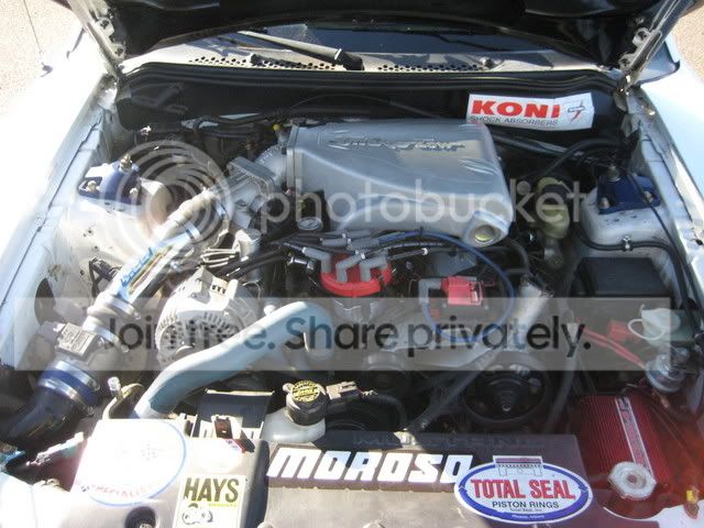

The schrader valve is on the fuel rail, kinda by the oil fill on the valve cover.  can you see where the small gage is on my engine? that gage is plugged into it in this pic its inbetween the spark plug wires and the manifold on the LH side as you look at the pic.
I forgot about the catch can trick, I used a Craftsman air/oil seperator that they use on air compressors, it worked decent. it had a small clear catch can on the bottom so you could see when to drain it.
