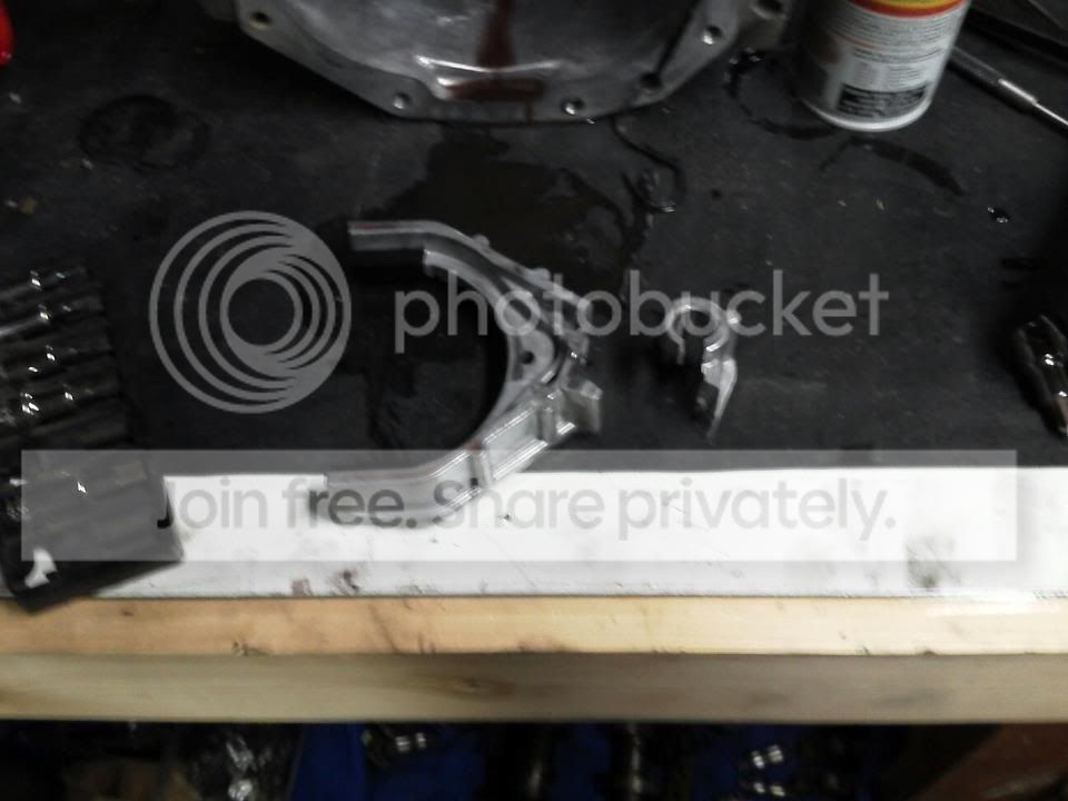

Well I got my transmission torn down today since I'm waiting on engine stuff and I found what I kinda figure I would find.
I guess I'm going to have order those beautiful billet shift forks I seen a guy selling, after Christmas. I still didnt see what was keeping the trans stuck in reverse, I'm just going to write it off as one of the busted pieces in there must have been screwing something up.
