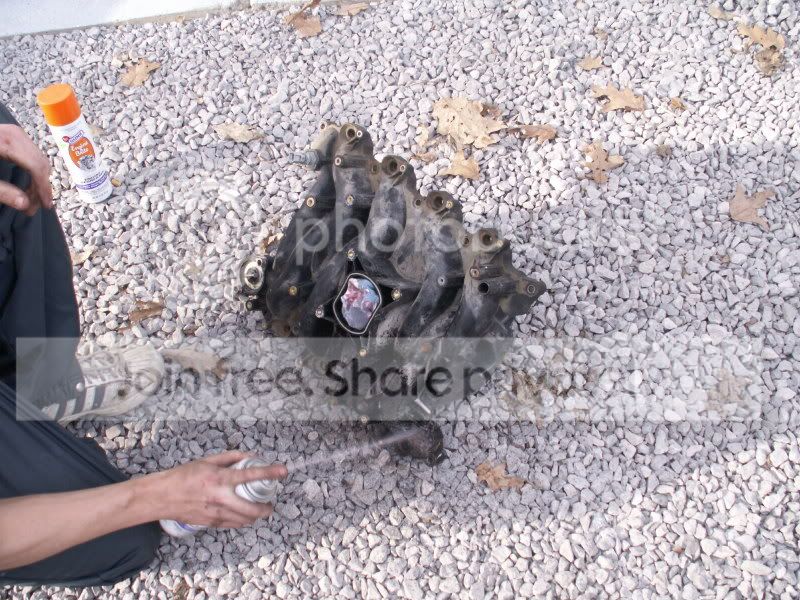

...not exactly sure where to post this, but hopefully somebody can help me out. I've got a 94-95 cobra intake that I had been planning on cleaning up and putting on the car when I install my blower. I've been polishing on it and working on making the outside look nice due to some chipping/flaking of the original finish. Well, in the last couple days I decided it was time to clean out the inside and get rid of some of the nasty carbon buildup.
I've got the lower cleaned up pretty well but carb cleaner doesn't seem to be doing the trick on the upper... how can I get it cleaned up. I mean, the stuffy is nasty, I can use my finger and knock off big flakes of black, something I def wouldn't want in my engine bay.
I have had such a hard time with it I've been thinking about selling the intake and just buying something new so I wouldn't have to deal with it.
what do you guys think.. suggestions?

I've got some aircraft stipper that I generally use to strip paint. It's what I used to strip the original finish off the upper... but I've been told that I can dilute some of that with water in a big enough tank then just let the whole thing soak and possibly clean out the inside... dunno, haven't tried that yet.
I don't know the major active ingredients in carb cleaner but it is supposedly the same stuff as in this aircraft stripper.

spent a couple hours on it this afternoon before heading into work. It looks pretty good, but I made a surprising discovery... It appears that the stock/factory finish that is on the intake seems to be on the inside as well... :dunno: weird, buy my guess is they just dip it in something.
the aircraft remover/stripper does a dang good job but there is no way to just let it soak/set long enough. I'm going to drop it off tomorrow at a local automotiver stripper place. They've got tanks of aircraft stripper that they say they can let it soak in. $50 and it should be clean as a whistle.
now I don't know if I should finish polishing it or just paint it and polish the raised lettering at the top...
