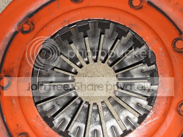

well this sucks, I pulled the cover off of the clutch fork. Theres lots of play in the fork and I can push the fork forward with my hand. This sucks I didn't want to have to pull the tranny out but it looks like I am. So anyone know of a good street clutch?

Heres the damage:

I want a nice street clutch that will hold the power which the centerforce was. I really don't wanna get another one but I don't see another clutch with the same street manners that will hold up to the power. This clutch broke because it was defective not because it couldn't handle the abuse.

FYI, I had a turbo shadow and the trans seal went out under warrenty, so I had them put in the centerforce clutch somewhat similar to yours. After a few years of use, it also self-destructed and there were parts rolling round in there it was horrible, the trans guy I used had never seen one where the clutch plate springs had broken loose. Told me that the "HP" ones were not always as good as their marketing and that he'd use a conventional style pressure plate and clutch any day. Get something else.
