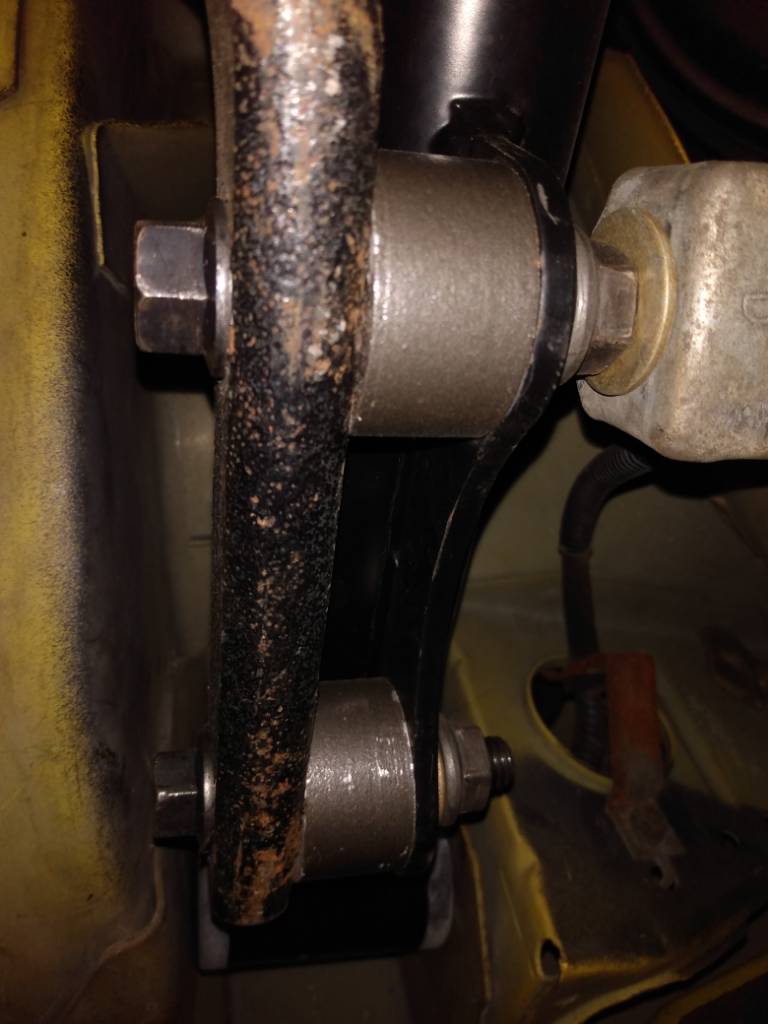

Cobbled together sway bar mounting
PinkieT
Jun 22, 2015
3,489
1,561
Cleveland
I have aftermarket generic LCAs. Lucked into a Hellwig rear sway bar for cheap. The problem was installing it as it mounts different from stock. I used washers as spacers to figure out dimensions, then had solid aluminum spacers machined up by a buddy. I painted them to match the bar.
