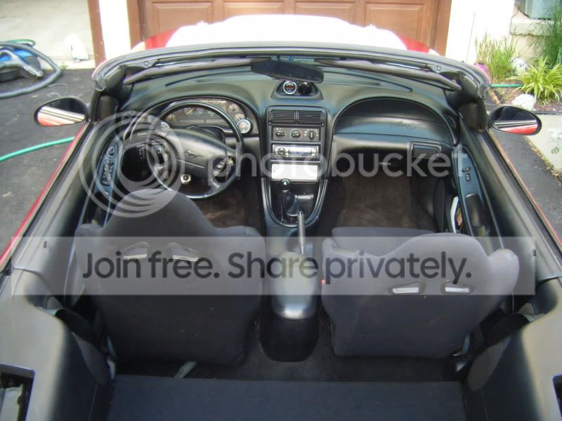

Well its taken me 3years but the car is almost one piece again. All of the work was done by me and my friend Chris (95pgttech) who i couldn't of done this without. (many thanks man) He let me keep the car at his place for the last 3 years. Dont be to harsh this was my first time doing any bodywork/welding or tackling anything this big in general.
I drove it around a bit today and the tune still needs work. (Lean on CL tip in). So i disabled CL at idle and that solved the problem for now. I cant wait to dial this thing in and get some numbers. The car turns alot of heads but thats probably because it needs paint bad. Im out of money to use on this thing so maybe next year.
http://s28.photobucket.com/albums/c236/blindfoldedhope/?action=view&current=DSCF6196.mp4
I still need to mount the switch for the line lock, mount the push pull cut off and do a few other odds and ends. Id also like some quieter mufflers car is to loud.

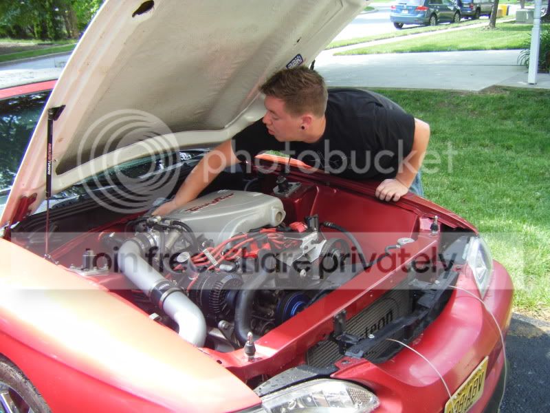

And what's all done to the engine? I see you have the Fox tb conversion and TFS intake.
dutch said:
awesome adam, that engine bay is sick

Very nice! That bay looks badass! Are those 17s or 18s? Also you could primer that hood back and it should look a bit better :D

Here is whats done:
0.030 Overbore 302
Keith Black Flat Top pistons
TFS/KPI HiPorts Cylinder Heads 2.02 intake valves
Comp Cams Pro Magnum 1.6 Roller Rocker Arms
Trick Flow Hardened Pushrods
Wolverine 1190 Cam
Trick Flow Track Heat Intake Manifold
Accufab 70mm Throttle body
Accufab 70mm EGR Spacer
FRPP Underdriver pullies
Trick Flow Specialties Valve Covers
Trick Flow Specialties billet fill tube
Custom 3'' Mandrel Cold Air Intake
90mm Lightning Maf
24lb Blue Top Injectors
Walbro 190LPH Fuel Pump
Custom Accufab 1 3/4'' headers (3'' collectors)
Custom Mid pipe 3'' pypes cats V band connections
Flowmaster American thunder Catback
FRPP Aluminum Drive shaft
Tubular QA-1 K member
9mm FRPP Spark Plug Wires
Autolite 24's
MSD Distributor Cap and Rotor
MSD Coil
Lokar SS Braided Flexible Dipstick
MR. Gasket 180* Thermostat
C&R racing Aluminum Radiator
Moroso Overflow Tank
Steeda Aluminum Lower Control Arms
Eibach Sportline Springs
Tokico Hp Blue Shocks and Struts
Kenny Brown Camber/Caster Plates
Ingall's Engineering 17mm Camber Adjustment Bolts
Hunsaker Racing Seats
Battery Relocation
98 tails
Cobra R Hood
Chopped Antenna
Mach 1 Lip
Redline Hood Struts
FRPP Hood Pins
Line Lock
Slotted Rotors
New Brake pads
New Rear Calipers
New Master Cylinder
New Starter
SS brake lines and All new Hardlines
Low Mileage 94/95 T-5
MGW Shifter
Hurst Shifter Ball
Poly Motor Mounts
New Ultra Clear Head Lights
StangMods 6,000K HID's
New Ball Joints
New Power Steering Rack (somehow the inner tie rod failed already)
New Inner Tie Rod
Poly Offset Rack Bushings
Polly Swaybar Bushings
2'' Poly Endlinks
FRPP King Cobra Clutch (New Throw Out Bearing)
Fire wall Adjuster
Clock Gauge Pod
Cluster Surround Gauge Pod
Autometer Sport Comp II DPSS Stage 2
Innovate LC-1 Wideband with DB Gauge
Autometer Sport Comp II- Electric Water Temp Gauge
Autometer Sport Comp II-Electric Oil Pressure Gauge
New Gauge Cluster
New Convertible top lift cylinder
Cobra R Wheels (17x9 fronts with 245/45/R17's TOYO Proxies 4, 17x10.5 Rears with 315/35/R17's)
Tuned With: Moates.net Quarter Horse and Clint Garrity Binary Editor and EEC Analyzer
25lb weight removed from fender
Dogbone Removed
Rear Seat Delete
A/C delete
Smog Pump Delete
Quad Shocks Removed
Shortened Dayco Belt
New Windshield
New Top, Pads, Rear heated glass
New speakers
New cLock Spring
Welded Steering Shaft
I think that about covers most of it im still missing alot probably...

Love the smoothed engine bay. What kind of material did you use for the fender pieces? I've got some pics of similar setups saved... if/when the motor is ever pulled from my car I will most def be doing some kind of setup to fill all the holes or just angle in some decent sheet metal for a similar look to yours.
hndaklr
Dec 28, 2009
26
Ya that smoothed engine bay looks kill, you don't see it as much on sn cars
Compared to foxbodys .. Again I'm from surrey BC Canada don't see much different stuff up here haha but looks good I wanna do mine like that
