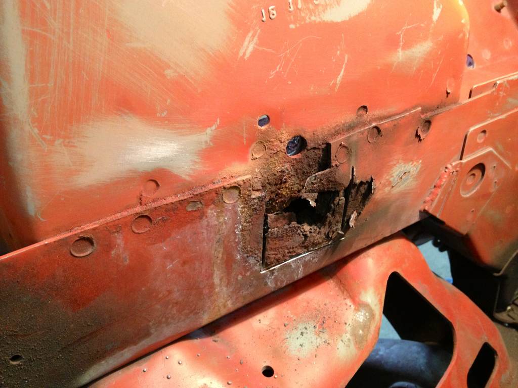

Funny though, I just fixed this on my car. Only thing to do is cut it out and weld in new metal. This can get nasty as the rust is past where you can see it so you won't be able to weld it properly without cutting out more than you need.

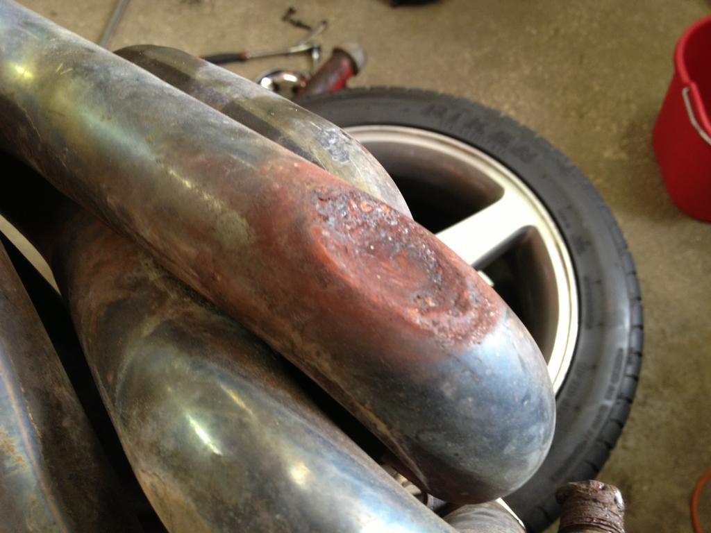

As I said and as you can see here, I just fixed this same issue. I'm not sure if it's a common problem or not because I think mine was caused by my shorty header being ridiculously close to the strut tower.

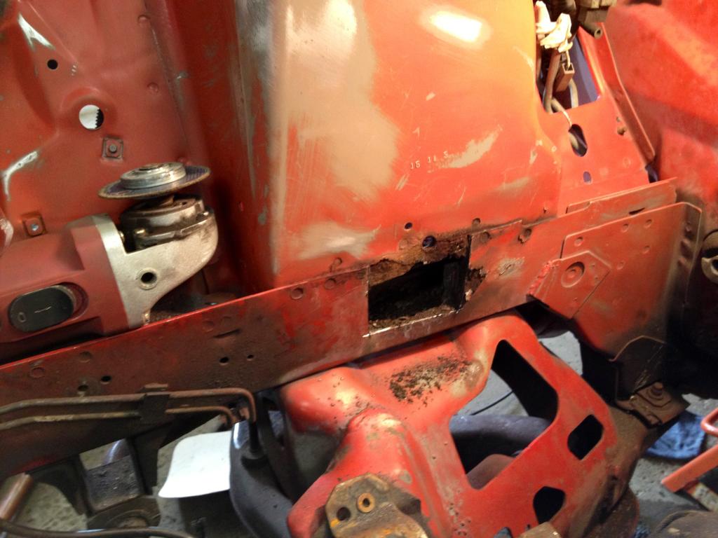

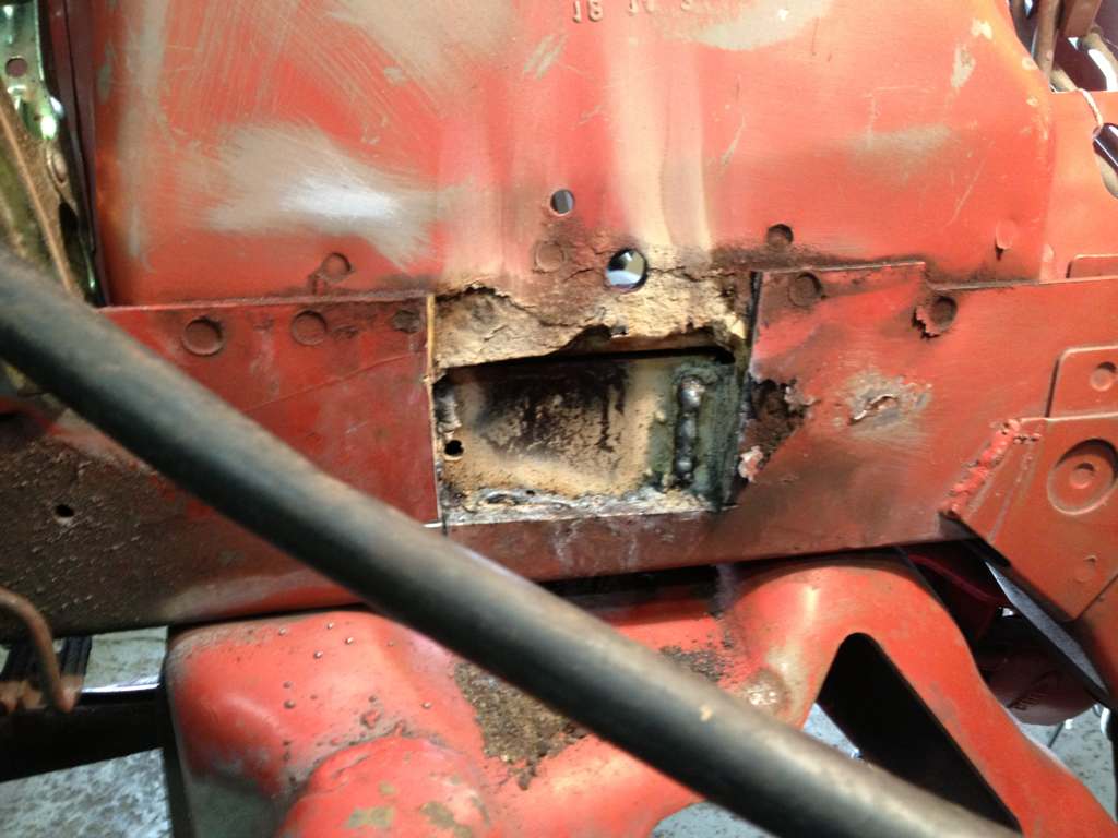

Yeah I've got plenty of pics of the progress. Unfortunately mine was a little too far gone and was gonna take some major repair that I didn't have time for, but you'll get the idea. I'll post pics tonight when I get on the computer.
EDIT: Here's the way it is as of right now.

Thanks for the pics! Gives me an idea where to start :) Definitely looks like that header was hitting the panel.
