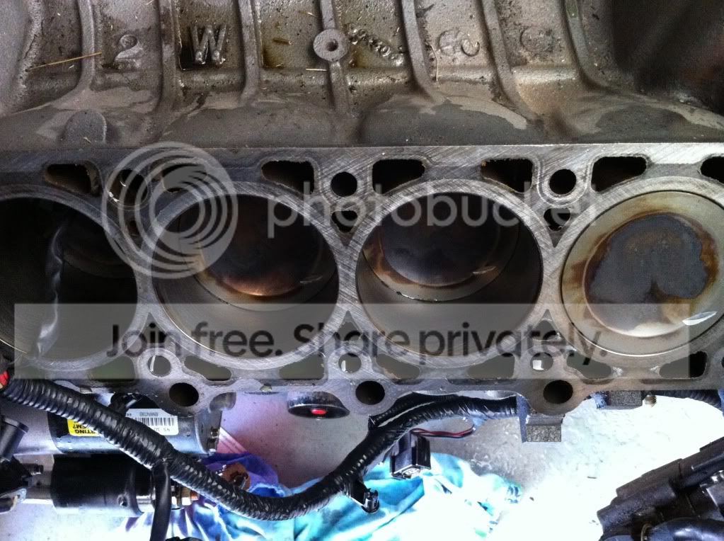

Man my pistons in the motor i just pulled out of my block did the exact same thing.. but all of my valves looked good still, kinda wierd..
as far as the problem, pull the covers and check it out man we can guide you threw anything you need on the site
