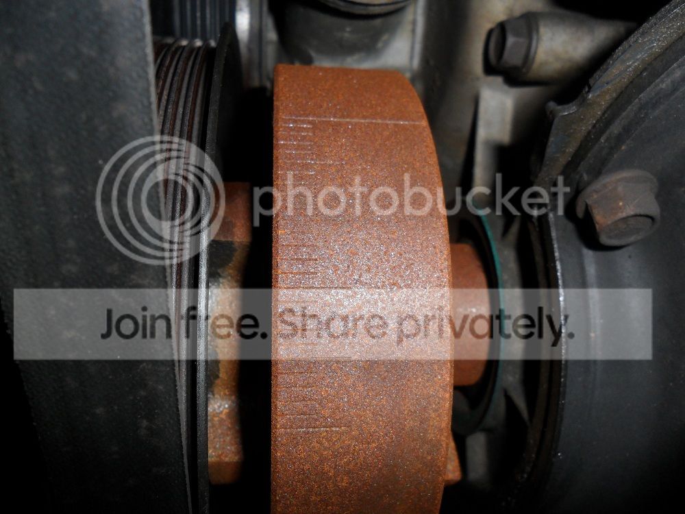

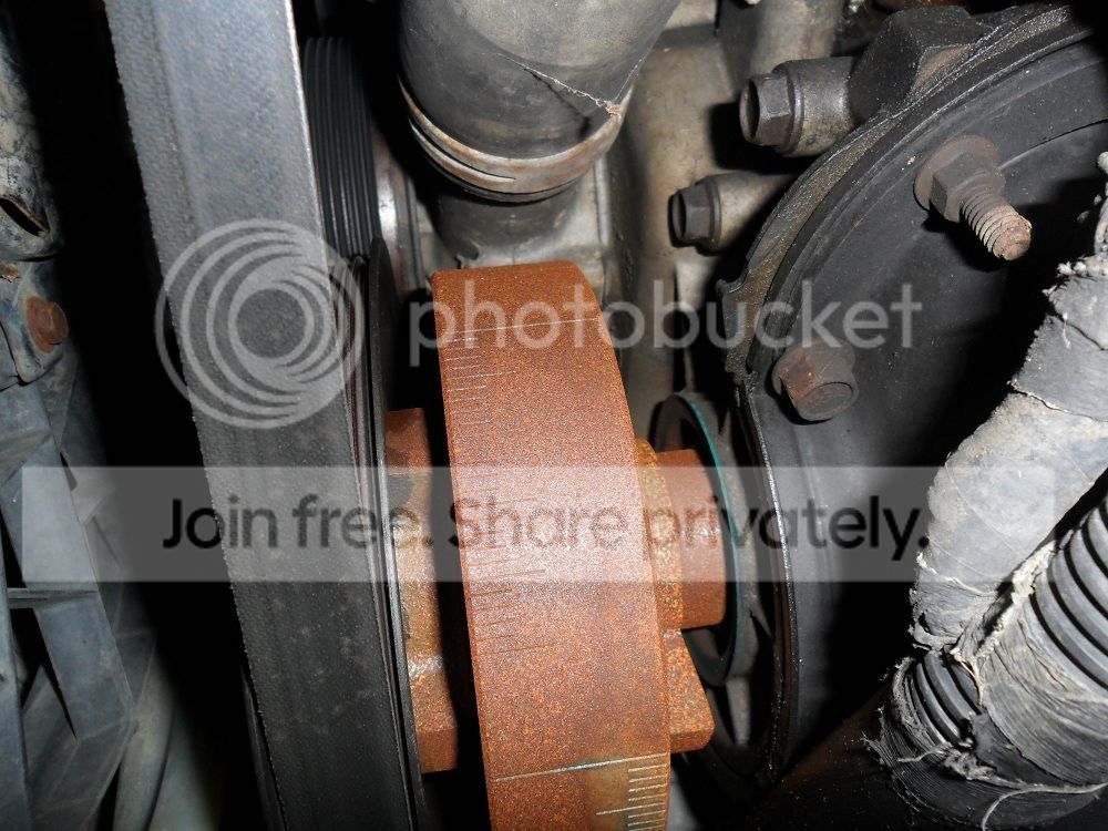

I ordered a Lunati brand harmonic balancer for my car, back when my old one went bad. Had the rubber sticking way out of it. So due to time constraints, and just plain "I don't want to", I had my trusted mechanic put it on. But I told him to set it to the same timing that the old balancer was at. So he did. But now, I want to change my timing myself and the dang thing doesn't have any numbers to tell you where zero is. Just a bunch of lines. So I have no idea where 10 degrees BTDC is. How can I find out?

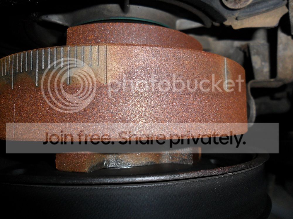

That long hash across the whole balancer is your 0* mark. Anything to the left is ATDC (after TDC) and everything to the right is BTDC (before TDC) going to the right your going to retard the timing and going to the left your advancing. You want 10* BTDC for stock setting but you can advance it 4* so you can set it at 6* (each small line is 2*)

I see what you're saying, but if you look at pic number 2, you can see that there are actually two of those long lines that go all the way across the balancer. I take it you are talking about the one in the middle of all the lines, and not the one on the far left, which only has lines to the right of it? (still looking at pic number 2)

The piston goes up, and then the piston goes down. With that being said, TDC (top dead center) is just that all of the way at the top. The piston has come all of the way up and has not yet start to go down yet. I think you are letting this get overcomplicated. Did you call Lunati to find out exactly where TDC is on the balancer? I think that Venomized was right that the long mark is TDC. call Lunati to be sure if you want,

It is real simple though. Turn the motor over until the big line is on exactly on the pointer. Remove the dist cap top. Is the rotor pointing to where the spark plug cable for # 1 cylinder is connected? It should be. If so your mark on the balancer is in fact TDC. 10* TDC is 5 marks to the right. Don't over complicate it.
