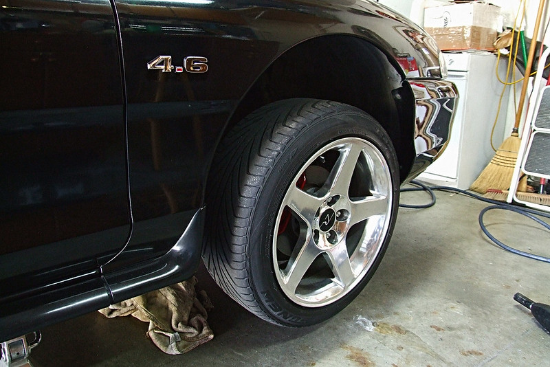

Hey guys, just been debating and going back and forth on a couple things and don't know which way to go. I currently have 17" chrome cobra wheels and I don't have big tires on the back at all. :( Now I know with 17" you can not go wider then a 275 if I wanted a Nitto tire am I correct? I am not to sure so if somebody knows more feel free to correct me. I was thinking about buying the best and biggest I can for the back tires or I was debating buying some 18" black FR500 wheels w/ a Nitto package that they have on American muscle. I love both wheels, and the package has 285s in the back, this is my weekend warrior car, maybe sees the track 2-3 times a year at best. Any ideas which is a better way? Money is a little tight and there are other things like headers and intake manifold ill be wanting to do at the end of the month. Any and all ideas are welcomed. Thanks in advance.
