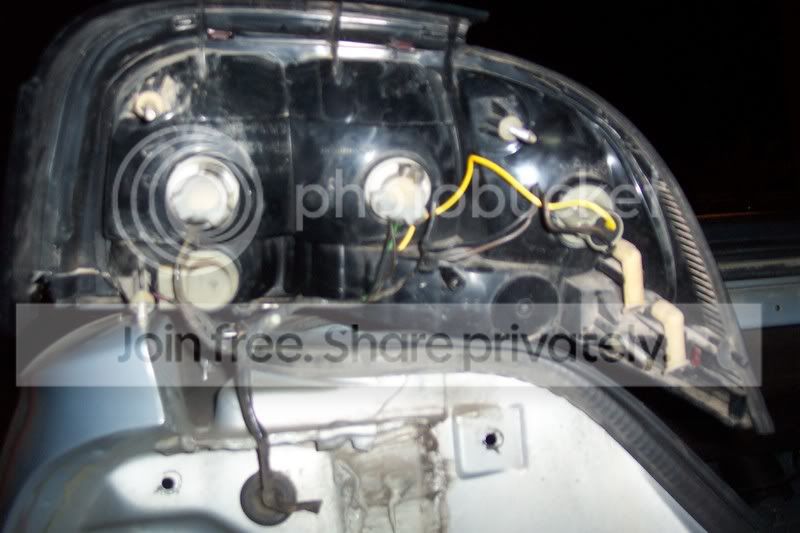

--first off start by taking out the trunk lining and un-screw the 4 little nuts holding the tail light in
--take it out and free the harness from the tail light housing

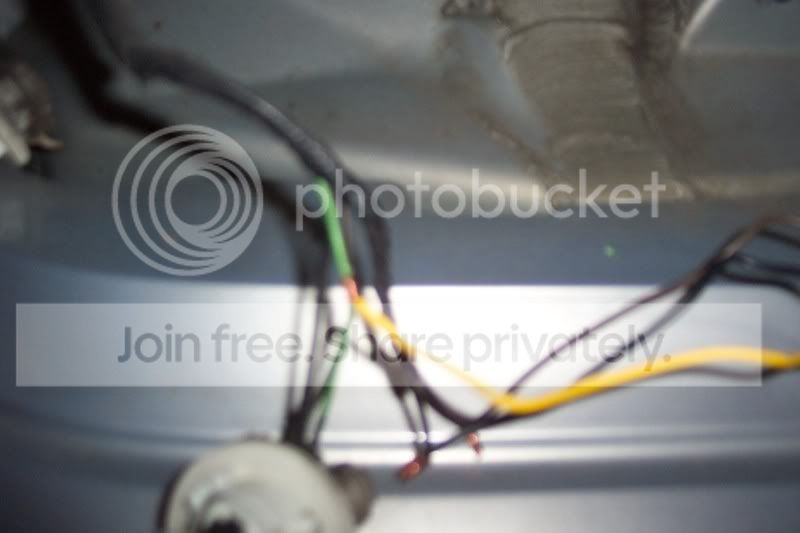

find the little bulb (you'll know which one it is) and cut it right off
connect brown wire to brown wire and black wire to black (pretty damn easy so far uh)
--stock tail lights only have 2 of the 3 lights come on when you hit the brakes and only 2 of the 3 lights flash with the turn signal
--tapping the yellow wire into the green wire on the light right beside it will allow all 3 lights to come on with the brake and flash all 3 with the turn signal
take the yellow wire and tap into the green wire on the light beside it, on the other side the wire was orange, so just tap it into whatever wire that isnt black or brown
and there ya have it, all done and wired up, do the same to both sides
here you can see all three lights come on when you hit the brakes and use the turn signals
