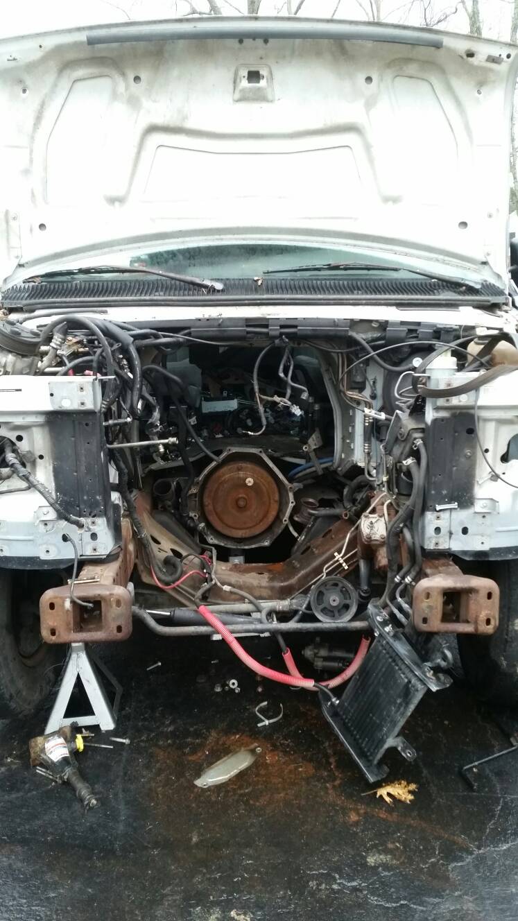

I am trying to think of a van that you could go from the top?
Sort of the top. More like from the front!
