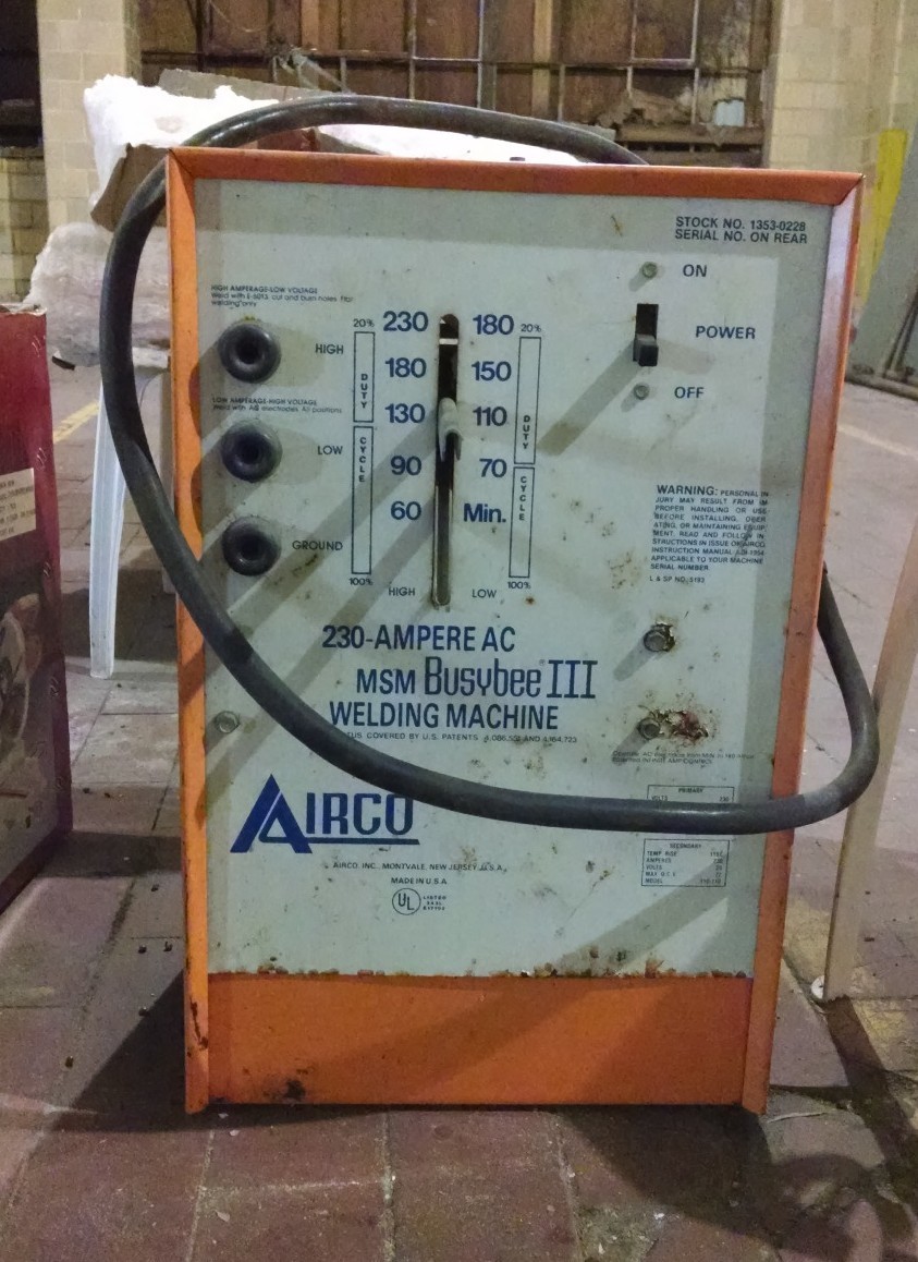

The only welding equipment I have is this dinosaur that was a souvenir left behind at my warehouse along with some masks. I know nothing about it...

Welding is out of the question because I'm not familiar with welding, nor do I know anybody around here that can help me with it. I'm not taking it to a body shop either because, let's face it, it's not worth dumping half of what I paid for the car back into it to patch up a few holes on the roof. (If it were one of my mustangs, it would be a different story.)
