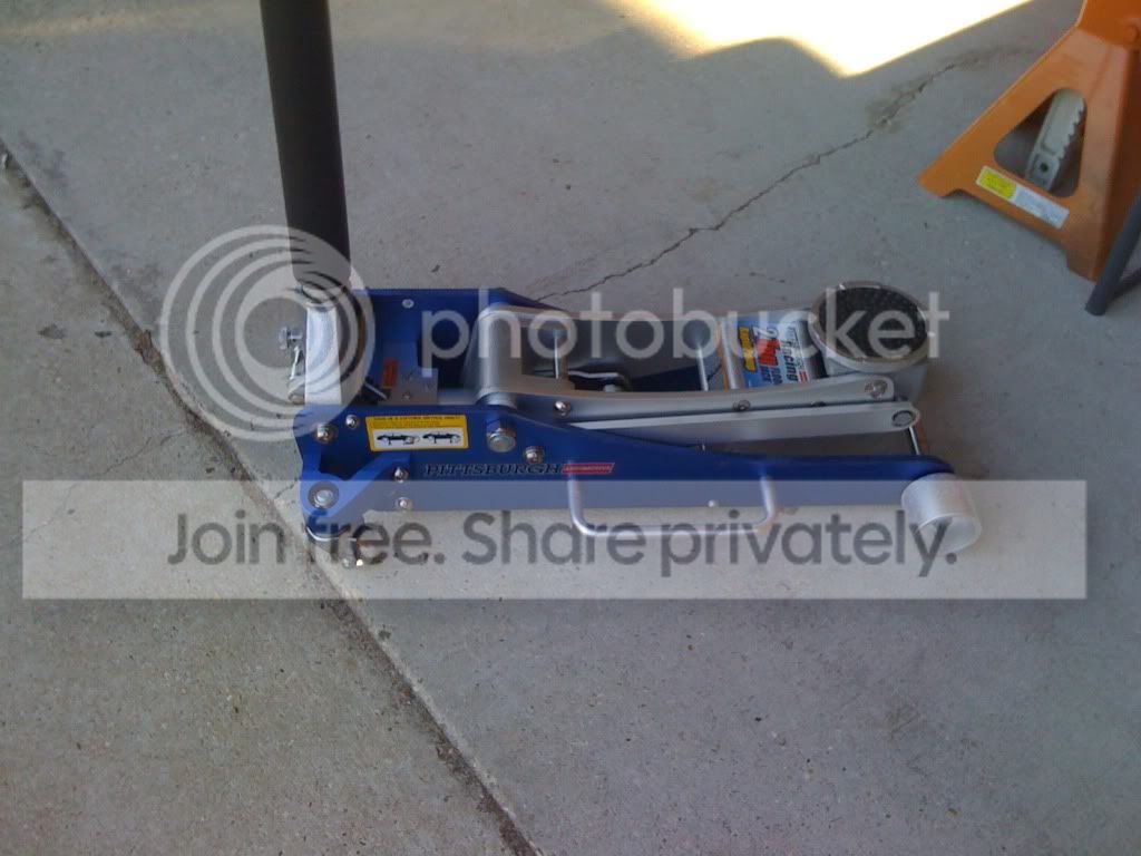

Ok I done it, harbor freight.
And a new creeper, not Harbor feight. I'll have to get the side trays too.

I've only used it a few times and so far so good. It looks to be very well built. For $39 you better go and get it.

Those jacks work great for lowered cars and are
Pretty light as well ... Gets under almost all my buddy's shit canned cars

My biggest problem with that harbor freight and low pro craftsman jack is they don't lift high enough. If I cant get the car up high enough to get my jack stand under the car at their highest settings....they aren't worth a crap to do everything I need to do. If I am pulling a tranny, I wanna be able to lay under it and "bench press" it in and out. I have a SUV/truck jack from auto zone that lifts the car as higher than my jack stands can go which is perfect. I can put the entire chassis on jackstands and still use the jack to articulate and move the suspenion if needed as well...great for rear end work. A jack that requires the jack handle to remain atttached to raise and lower the jack is garbage IMO. Say you need to raise the entire rear of the car or just put the jack under the car to support the tranny....you gotta keep the handle on after raising it to be able to drop the car leaving it in the way, jamming up under the car. I prefer to have a jack that has a seperate relief valve off of the pivot point used to raise the jack. I support what ever I need to, remove the handle, do what I gotta do and then drop it.

^ I agree with this.
I need a new jack soon and removing the handle is a big deal. My ancient jack had one of those little metal wheels snap in half while lifting my buddys car, pretty much sure it's not ok to use anymore.
But that old jack also had a height issue, so I would have to put 2x4 pieces on it to get it up a few more inches to use a higher setting on my stands.
Go with one that lifts high. Obviously its late now because you already got it. Just for anyone elses reference ha :)
