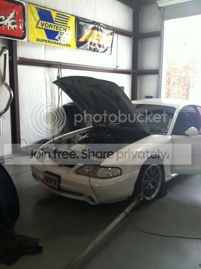

Well tomorrow I have a dyno appointment with Bob Kurgan to have my new-to-me cobra dyno tuned. Right now it makes 380/380, its a basic 1.5kb, on 11 psi with meth. I'm planning on getting a more conservative meth tune and a non-meth tune in case I ever run out of meth. I'm considering going to a 8-9 psi pulley, for motor longevity's sake, but I'll consult with Kurgan before I do that.
Is there any thing that needs to be done pre dyno? Things to know? I want to be as prepared as possible. Thanks!

Well I got dynoed today at Kurgan Motorsports. I made 335/318 at 5 psi. It turns out that when you combine a 11psi supercharger pulley, with a steeda underdrive crank pulley, plus a wrong sized belt, you only hit 5 psi lol! I also had a giant crack in my meth line, that they fixed, in addition to my ait sensor, being screwed up (it was incorrectly installed into the intake manifold). Overall I'm pleased with the results at 5psi, Bob Kurgan told me that once I get the belt/pulley/iat sensor corrected, I will be at 400 rwhp, so I'm looking forward to that. Kinda lame that so many things were screwed up, but atleast I now have a safe, tune, and I won't use a gallon of meth a day! Also you can see I was having some spark blowout at the top end of the pull.
