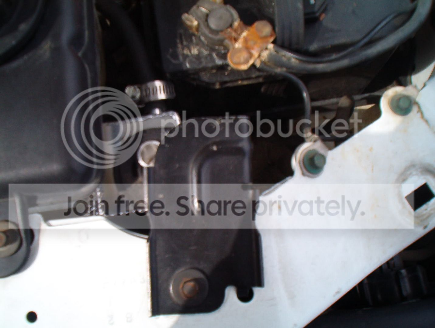

Yea, i plan on doing that pretty soon. I'd ask for them to exchange it, although my stock radiator is busted, and i need the mishimoto in there, and the fact that i cut my grommets to make them fit, and i already spent 3 hours putting it in. I'll go get some pictures.

Notice how the grommet is really stressed.
You can see the side box doesn't seem to be welded on straight.
