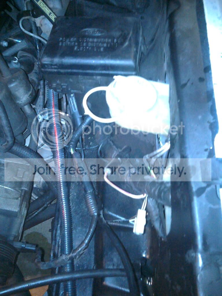

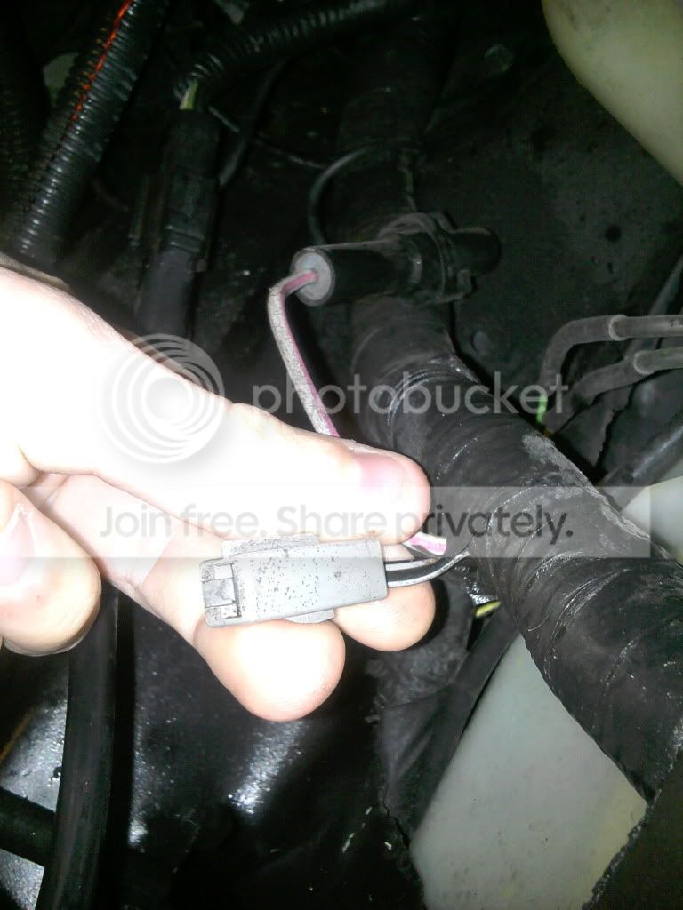

Grey Wiring plug next to battery tray... Dont know what it is?
9550mustang
Jun 16, 2010
40
Orlando, Florida
Grey tip plug beside battery tray, and i dont know what it is... Also, the door sensors dont work could that be it? And i think the rear window defroster may have been yanked out?

i think i know what youre talking about, but i asked some local guys here and they didnt know either. mystery plug/connector, seemingly goes to nothing, but then again, my gts doesnt have a lot of options either (like a battery tray! :thumbsup:) so there are a few connectors left undone :(
Would that be your mystery connector? if so, i would also like to know what it goes too :)

Comments like these kill me lol. No that connector is prob for something the car wasnt equipped with ie a 4v engine, 2v engine a v6, abs, fog lights ect. Alot of these cars come with connectors they dont need (ie convt wiring for a coupe) Its easier to wire teh car for everything and use as needed then make a few different harnesses.

Not to bring back a 10 year old thread,but just in case someone needs this info too and they locate this thread through a site or Google search,the single terminal plug in your pictures is the WINDSHIELD WASHER PUMP PROVE-OUT PLUG.IOW - its a test plug for the washer pump.You turn the key on then run a jumper wire from chassis ground/neg battery post directly to this plug and it should trigger the pump to spray washer fluid on the windshield.If it doesn't,theres an issue with the pump.Hope this helps 10 years later.lol
