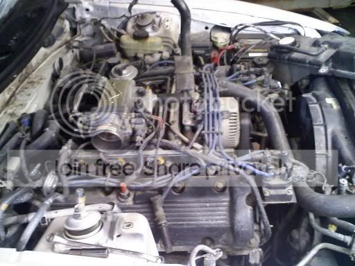

ok so i checked the plugs, there motorcraft platiums gapped at .53-4 and they have a pretty good burn pattern. a little more carbon then i would like but whatever. this thing is a mess, none of the panels line up at all. the hood has been refiberglassed thats right, the entire underside of the hood is a wreck of fiber i dunno if i will be able to solve that problem. whoever painted it oversprayed onto everything. its even inside the trottle body. most of the wiring looms are white now the ac lines are just hanging loose. the radiator overflow is busted and just sitting ontop of crap loose. the fan shoud is zip tied to a rad hose. and the core support looks like it was hit with a 5lb hammer everywhere.
im going to have to upload pics so you all can understand just how much of a pile this thing is.

If you got good vacuum on the end of the valve you should be alright as far as the oil. Mine had a lot and I changed it out and my oil on it was a lot less. Motor looks like its been sitting there for a while. Looks like spaco*sp* on the tb(thats good for airflow :laughing5:) lol. and I got a good laugh about you flying by the seat of your pants heheh.
But yea there looks like a lot of things that need to be done to that motor. i had to use my phone too look at them so it was hard to see stuff but when i get home tonight i'll relook at the pics. I would start with the cheap stuff first and then on.
