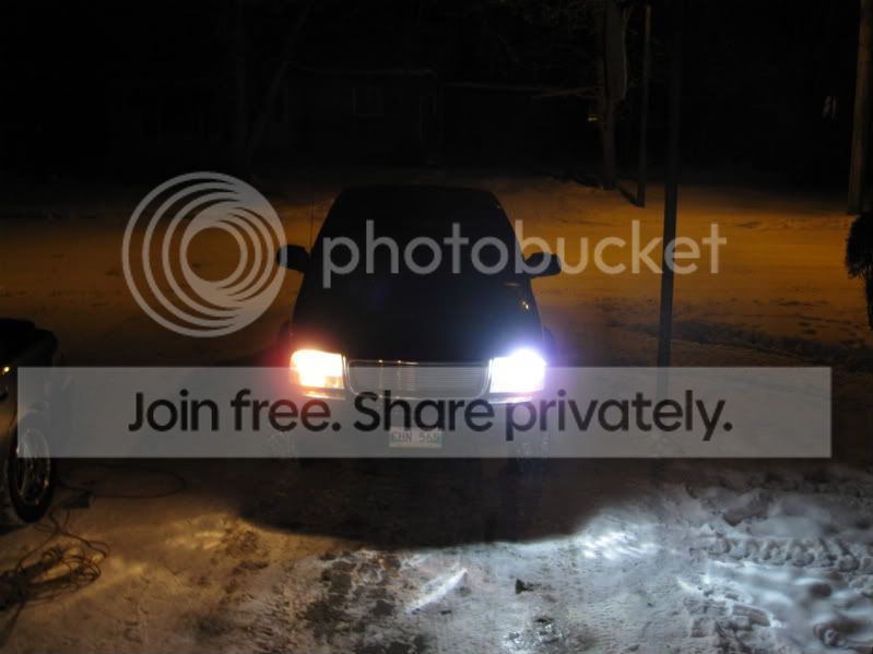

I got 8000K. It is actually for my Sonoma ZR2. They look very good. There's a little flicker when they are turned on cold though.

There should be no difference plugging into the stock bulb harness as a 12 volt source.
Here's a pic to see the difference if anyone wanted to know.
