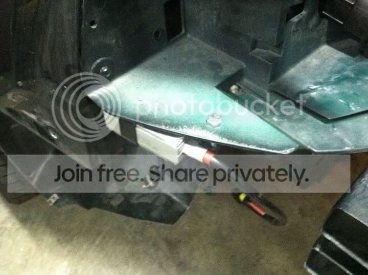

if you want a clean install here's what I did:
HID fog ballasts under the headlight panel and HID headlight ballasts in the fender wells. You can't see an inch of wiring once you've done it like this.

very clean and nice install

Hey thanks for the pic! I was thinking they wouldnt reach if I mounted them in that area. Now to make up some brackets for them. I dont trust the double sided tape enough to keep them held down with the crappy weather we have here in Ohio.
Madstang, thats a great spot for them. Thanks again for the pics!

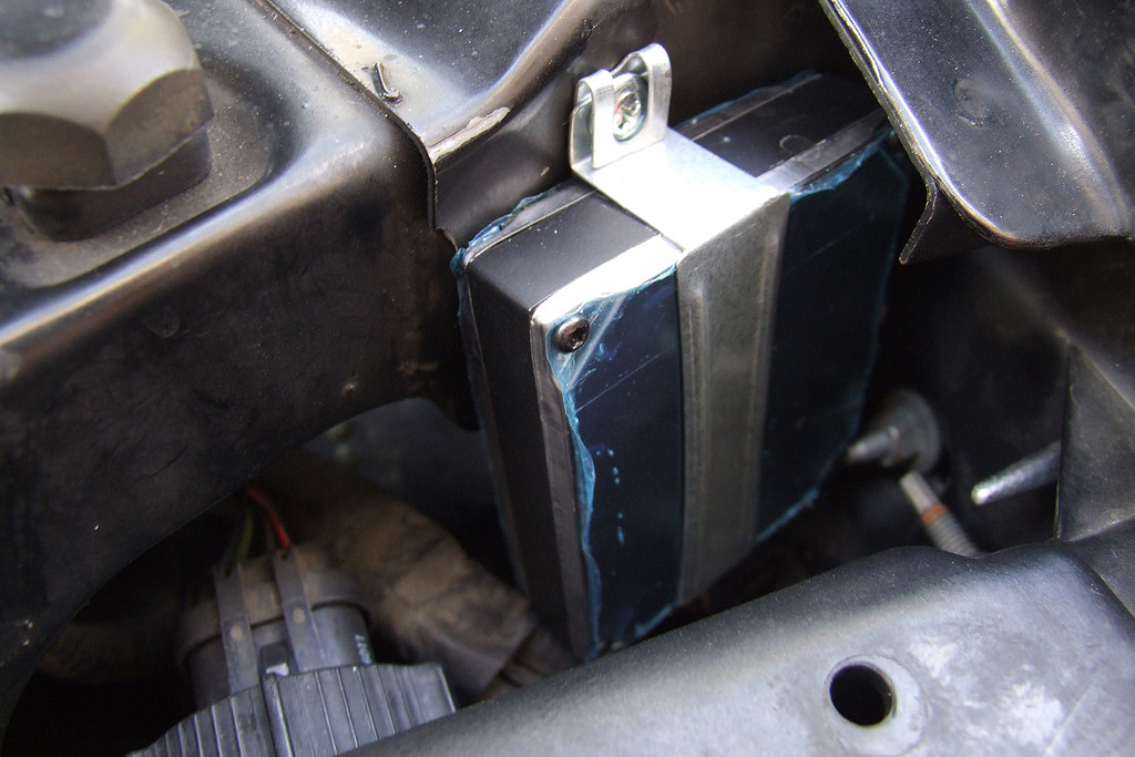

dont try the velcro crap they send either lol..on a hot summer day mine decided to come unglued and i drug it for god knows how long..still works but pretty sure itd give somebody a seizure till it warms all the way up lol. i mounted my brackes on the back of my crash bar on the front..no pics but im sure you get the idea..
