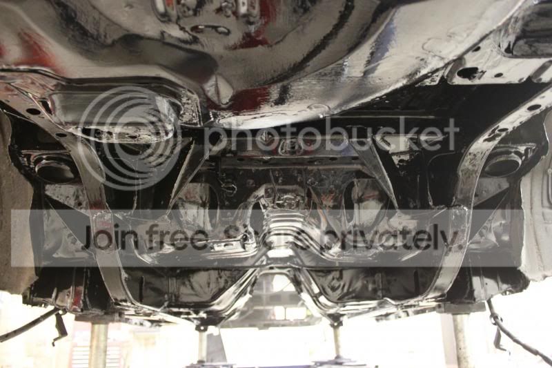

FIRST UP! was getting this chunk of iron out.
Out with the tank!
No Mo' Interio'

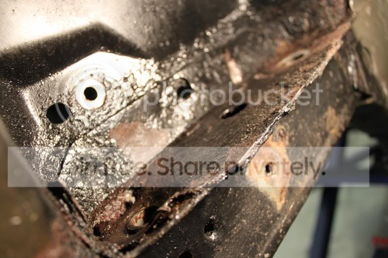

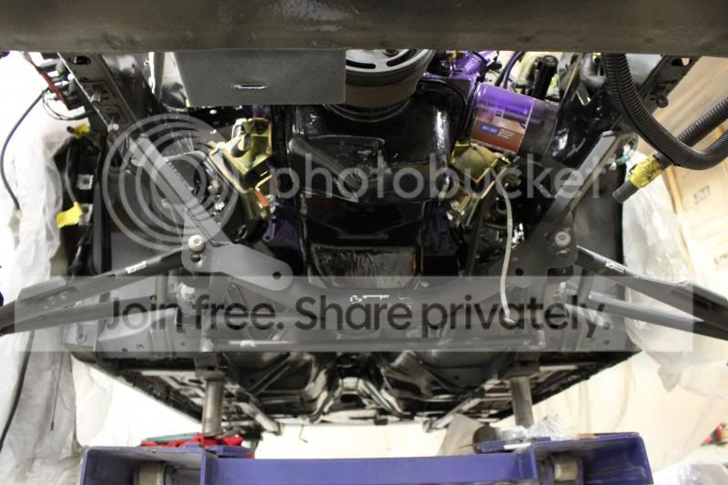

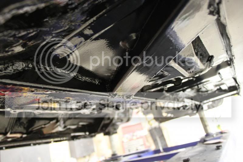

Is this bad? Before and after my awesome repair. :grin: what you CAN'T see is the crap load of mess that was INSIDE the frame rail. I had to rebuild my own crush tubes for the K member bolts, weld them to a plate, then box it all in. Needless to say I kinda overbuild the sh1t out of it.

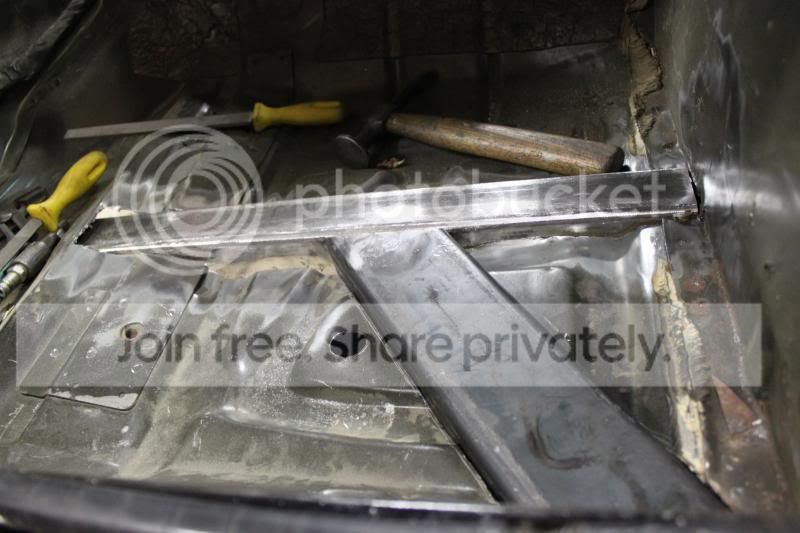

I liek subframez. Wolfecraft racing thru-floor subframe connectors!

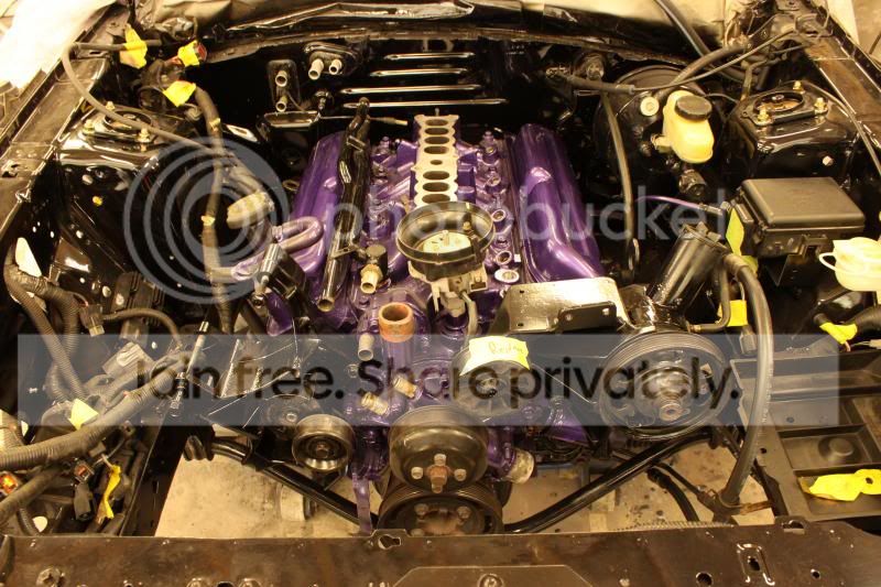

ARP head studs...
The rest was history!

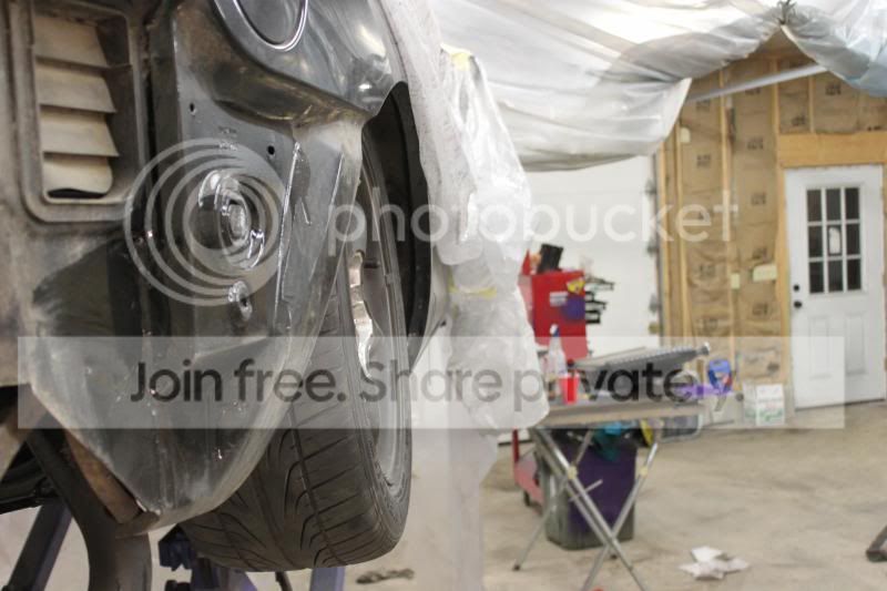

I could swear... It also kinda looks like pic of your car in your sig has some camber out back, Just wondering.

dam dude that rear is tuckin like a sum biitch hahaa! i'm sure you are'nt gonna stay that low, lol. i am def keeping an eye over here though lol. looks like its gonna be sick dude.
I have a quarter inch of clearance between the tire and the wheelhouse, I could notch the wheel well and add a few bumpsteer shims and go a lil lower... :shocked:
I'll work out stance when the car is on its wheels and I have the cosmetic stuff I want but It will be interesting!
