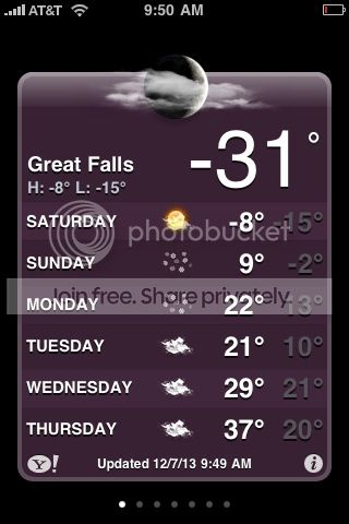

It's brisk out now but we just keep on cruising!
Feels like -47C or -52F
