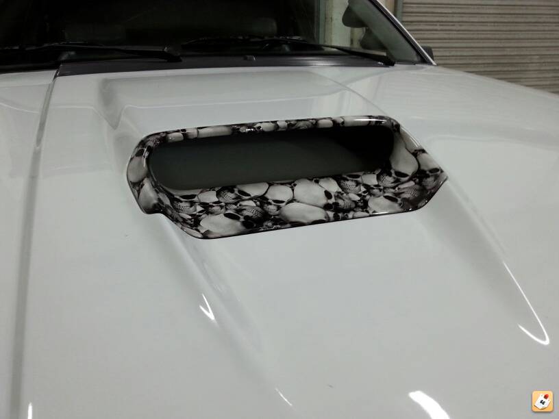

SVO Hood scoop insert

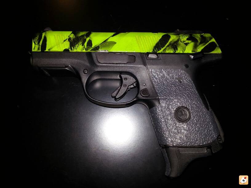

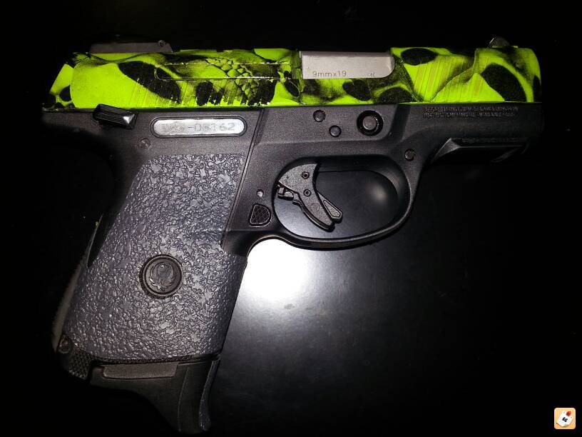

Ruger LCP
Ruger SR9C

how much is it to do the slides on the pistol? How well does it hold up to heat and does it come off easily if you need it to?
I think this would look pretty cool and my XD compact. Maybe with some ghost skulls so you couldnt really see them unless you looked.
Gun stocks and grips have been done all the time. Getting it of isn't like peeling vinyl ..they shoot clear over the print. So basically youd have to sand it off.
Its not air brushing so I'm not 100% on a ghost skull type pattern, unless we did a darker primary color so it didn't pop out at first glance.Holds up to heat, elements etc well. And is hard to remove like say paint or powder coat.
Has to be sand blasted, sanded or similar.
