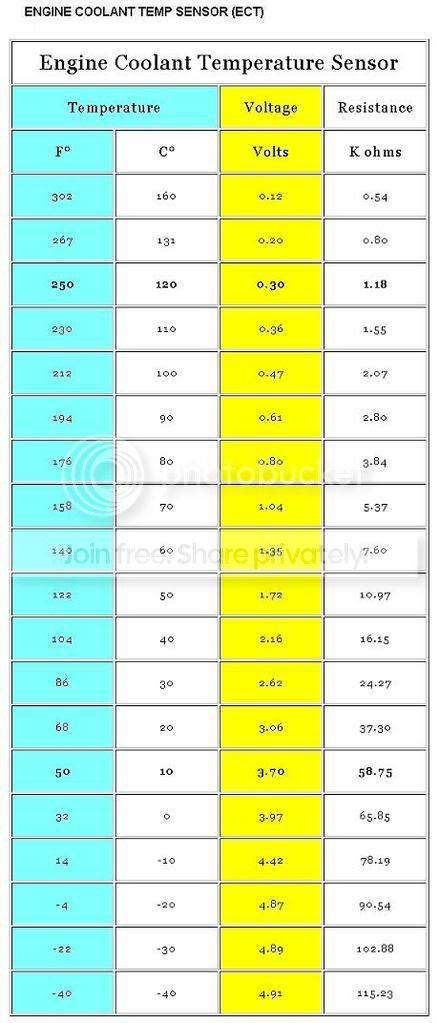

ECT sensor should throw a code. But before you just replace it put ohm it out and see if its about the same as the temperature outside or the coolant temp if car is warmed up.

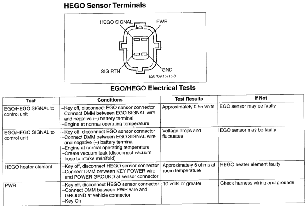

**if your o2's are bad, will it throw a cel? or do you just replace and hope for some good luck?? because it will studder with partial throttle and then if i put it to the floor 9 times out of 10 it will just start pullin hard like crazy. so im hoping its only something simple like the 02's. because i would just unplug them and leave them on the ground and they may have got kicked around**

You'll get a lean or rich code most likely. But don't run and replace your o2's You need to test them because they may be working and your car is running lean/rich . Catch my drift?
