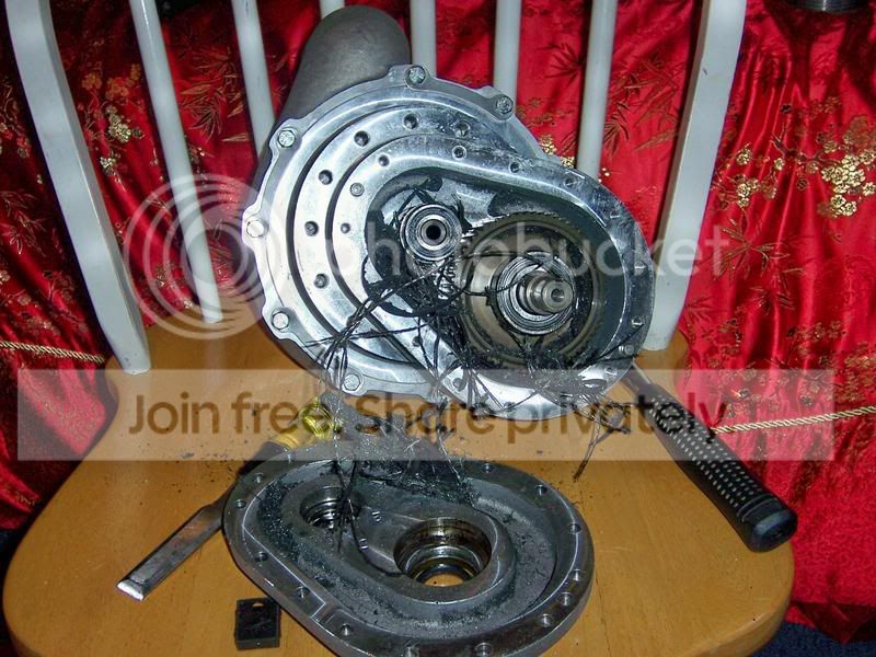

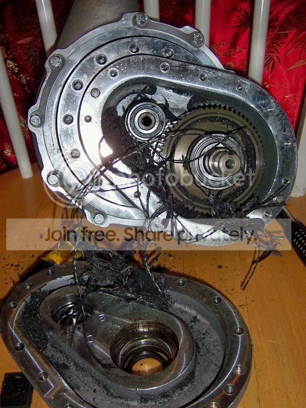

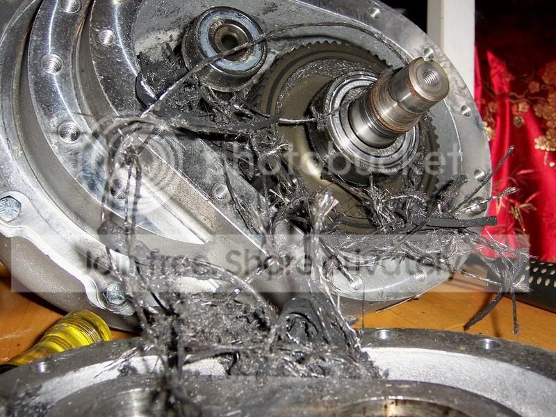

You see tons of rebuild kits on Ebay for a reason.
