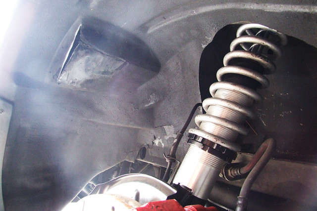

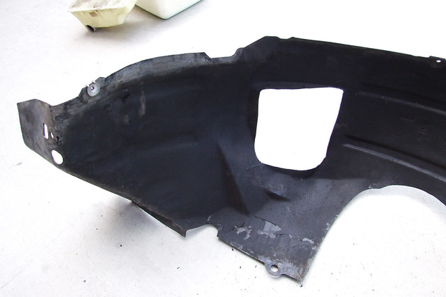

I wouldn't remove them if I were you.
Why is your tire hitting the fender to begin with? Is your spring rate soft? Are your bumpstops not working?
I modified my fender guards because my car was rubbing, but that's the only problem I have.

Just do what [MENTION=15502]Ferocious[/MENTION] did and just trim out the part it rubs on
