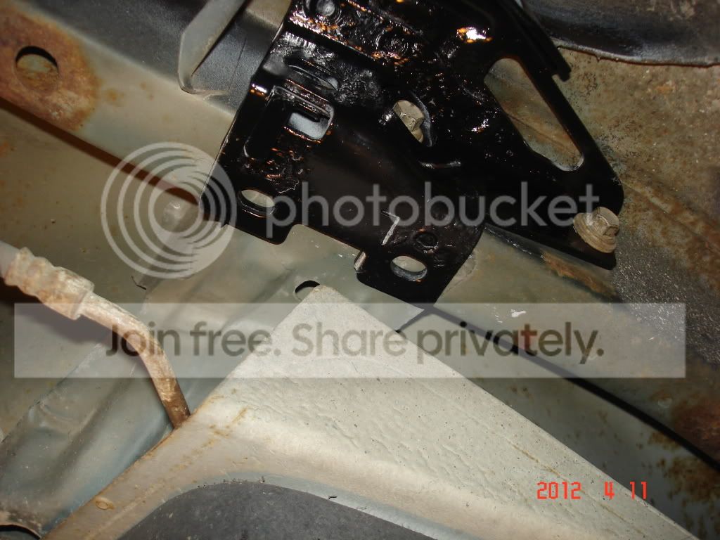

here is the upper sub frame bracket.
it uses the two existing bolt holes that were originally there for the quad shock mount, shown here.
here is where I have seen people drill and tap for the other two bolts that are on a cobra.
I don't know why someone would cut into the trunk floor, but I do remember seeing it before. I plan to weld along the front and rear edge of the bracket, rather than drill and tap holes. mainly because I don't think that minimal amount of thread would be good for anything but ignorant peace of mind.
on another note, I know I have to clean up some rust. it will be done when I drop the tank for welding.
hope these pictures help clear things up!
