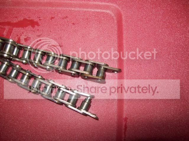

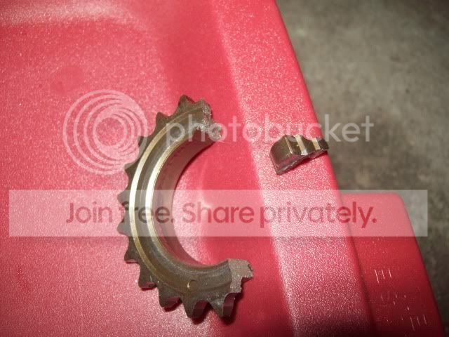

last saturday, I decided to get a little squirrely since I had some douche in his ride with 24's behind me revving his shit. I made it to about 3400rpms when this let happened:
Secondary timing chain broke, the tensioner extended and hung the chain against the primary chain guide and it snapped the cam gear into 3 pieces. At least that the way i think it happened. Yay.

If I were you I'd degree the cams to make sure the motor did not jump time on that bank. It's very likely that you damaged the valvetrain.

After putting it all back together, it runs and drives but I'm down on power quite a bit. I haven't done a compression test, I'm sure it'll tell me I bent a valve.

^^ That's very likely, at least one.
It is possible that if the compression check shows that the valves are ok - the two banks might be off from each other, the comp test will show that too.
Sorry to hear about this, was there any warning, like rapping/tapping/low oil pressure?
BTW I do have some extra valves kicking around if you need.

Not a bit of warning, it just went all at once. I may have to hit you up on those valves, depending on what I find.
