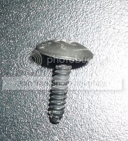

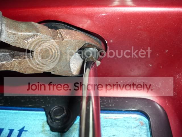

Ok, here's the info with pics
The little screws are very fine threaded, the plastic inserts are so poor that they are more of a retainer then a screw
Your flathead idea probably would of worked, just make sure you are grabbing the screw itself and not the raised area on the bulb holder. This is how I do it with a set of diag cutters, just work it behind the screw then using a little force pull the screw right out.
To replace the screws just push them in, dont even bother with a screwdriver

Oh great idea with the cutters. Thanks man!

So this ended up being stupid simple once I saw how joekd did it. When I initially was trying to pry these things off I was trying to do it at what looked like notches under the screws touching the bulb cover, but actually as seen in joekd's pictures the screw head is really thin and you just need to get under it with something. I used some sort of cutters similar to joekd's. Once I pulled them off there was some nasty looking corrosion up in the bulb cover and bulbs, and as greebscobie pointed out some of the area was melted and gluey looking due to heat. I tried taking pictures of what the crud looked like but they didn't come out too well:
