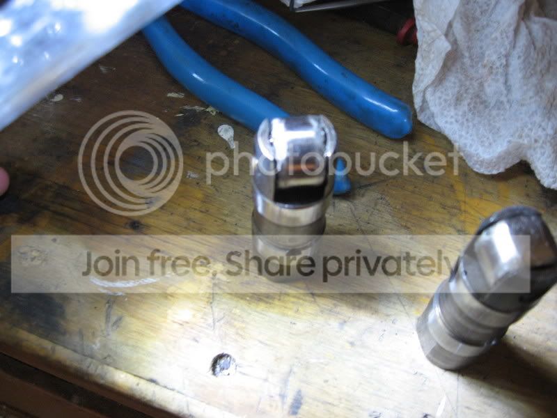

has anyone had a lifter actually turn sideways and destroy itsself and the cam before? how can they get out of the t bone bracket? i found this on one cylinder in mine. both lifters chewed up on sides and a huge flat spot. and from looking down you can see the cam is shot.

I heard of of this happening when over revving a motor. Never seen it. WOuld you be able to post pics.? that is something that would be educational to see for sure.

heres some pics, not the best quality but you can see.
