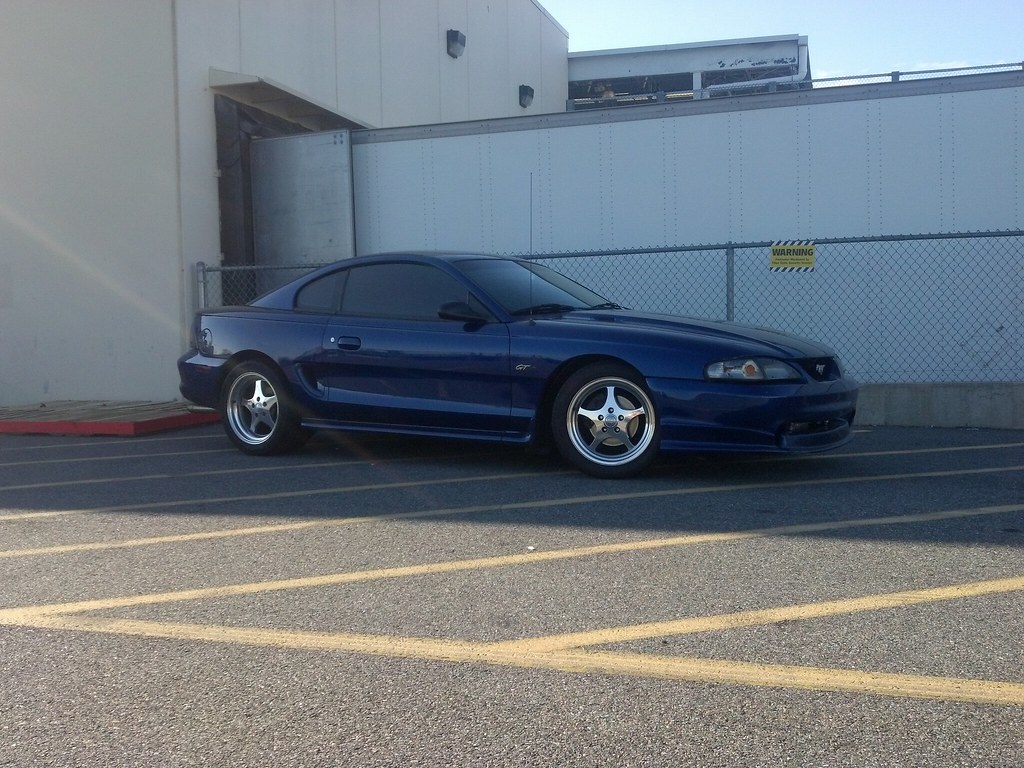

found this pic on another forum or is this too low for a daily driver? i aint much into suspension work....thats my dads specialty im more into the motors and shit

i have the QA1 coilover kit on my car and SVE rear spring, heres a pic
i can lower the front more but im not until i get a few needed items (C/C plates, bumpsteer and offset rack bushings) and im probably going to go with an adjustable rear lower control arm so i dont have to cut mt springs
I would say thats too low for a DD.
Ive got eibach sportlines with no isos and my car rides pretty damn bad.
With coil overs you should be able to go lower without the ride being as bad as with springs but still, there wont be any suspension travel left if you go much lower. lol
These cars really arent designed to be that low.
it depends. how are the roads where you live? if you dd using a well paved high way, it shouldnt be a problem as long as youre careful.
if your roads are pretty shitty, i wouldnt give up my ride quality and possibility of scraping just to look 'more aggressive'.
you can't be aggressive in a car that hits rock bottom every time you encounter a speed bump.
