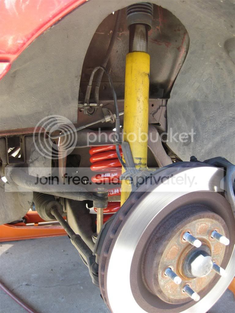

Blind
Feb 2, 2008
473
part of that write-up is wrong, it says remove the ti-rod from the spindle, but that should be remove the swaybar endlink bolts, as you can see in the next picture below that the swaybar is off but the ti-rod is on, there's no need to remove the ti-rod to do the springs/struts/cc plates.
